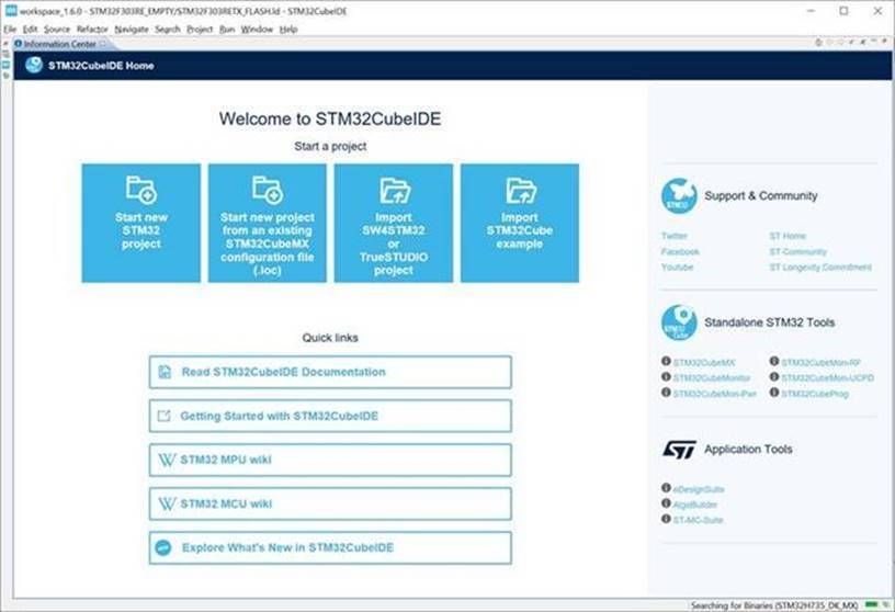

	Cube IDE Information Center
In CubeIDE click menu: Help > Information Center
The CUBE IDE Information center gives access to the following manuals:
