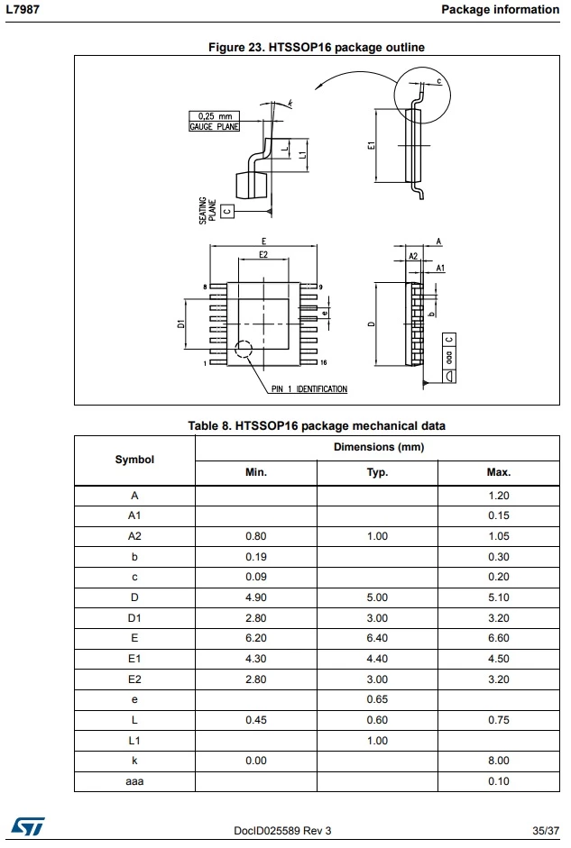

Where do I find package footprint dimensions for the HTSSOP16 package used by the PM8800? More generally, where are ST Micro's package specifications?

    Mechanical Data is usually in the Data Sheets..

    Thanks. It is missing in the PM8800a datasheet.
