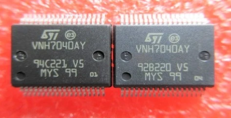

what is the part marking decoder for VNH7040AYTR?
VNH7040AYTR, does the part marking with any relationship on the tracecode of the label

Traceability would come from subsequent lines on part. Indication fabs, plant and date codes.​

Can i get the trace code from below marking information on the device?

Not exactly, but you should be able to cross-check the lable​. Assembled on different lines, a week apart.

If someone offers devices with labels where the Bulk ID and/or parts of the trace code(s) have been made unrecognisable, a lot of scepticism is always (!) appropriate because the person has something to hide. Either they are counterfeits or illegal resales.
The trace code alone is not sufficient for a well-founded statement.
