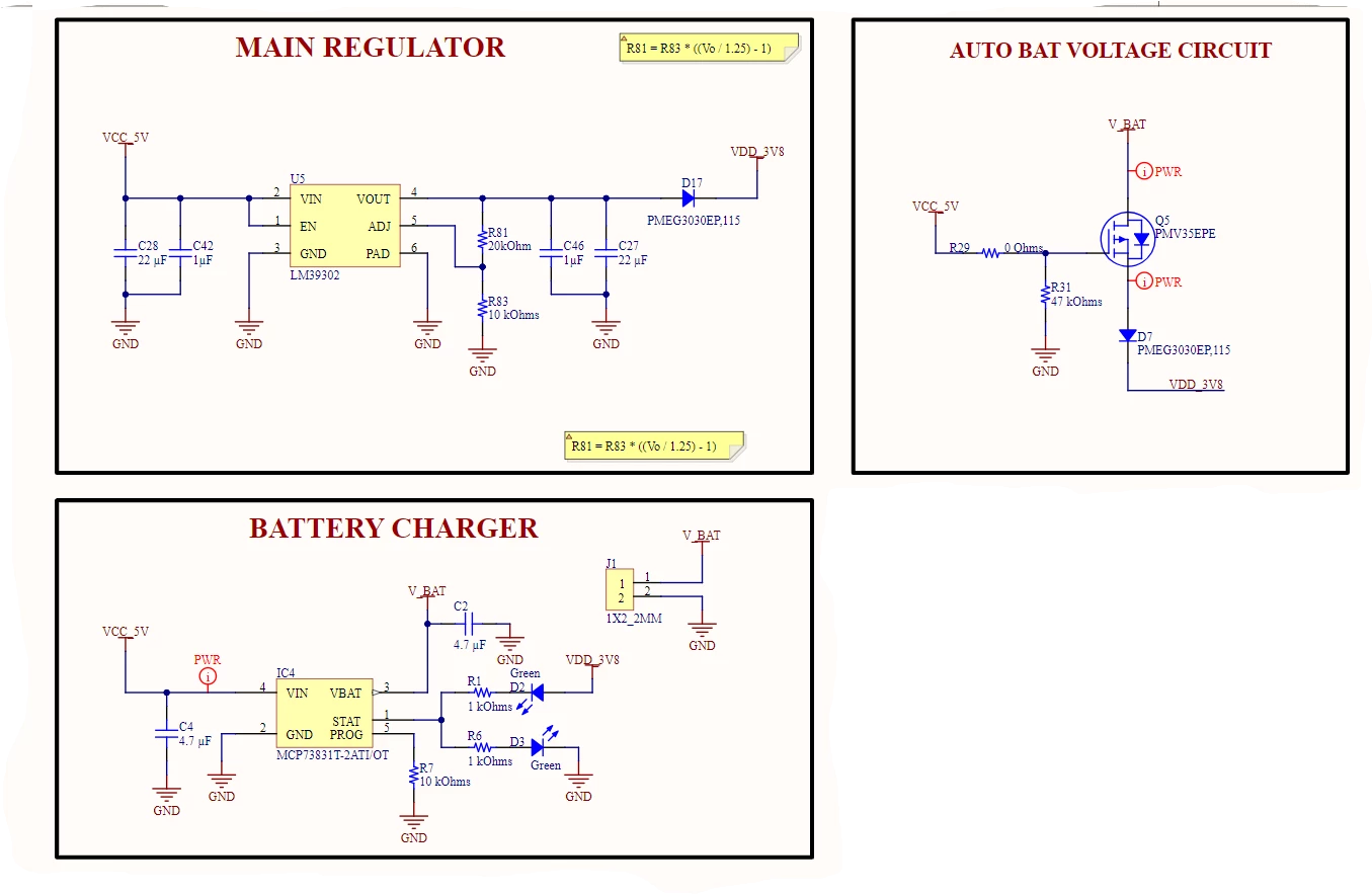

Hi Team i designed the schematic shown below for my automotive GPS Tracker
Screenshot 2024-05-27 1500131355×883 62.2 KB
Here i used diodes for droping the voltage
  1. main regulator D17 used for 5 to 3.8v approx.
  2. auto bat circuit D7 used as 4 - 3.8v approx.
so I'm Just thinking that is it the correct way to do this for long run
or any better way to do this
please give your suggestions and recommendations.
