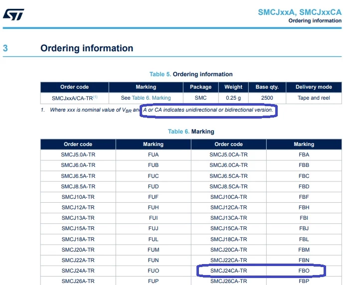

    FBO SMCJ24CA-TR https://www.st.com/en/protection-devices/smcj24ca.html
    Bidirectional TVS diode

    thank you, how do you know that this is this ref SMCJ24CA ?
    Tesla DeLorean
    Guru
    Jul 6, 2021 3:59 PM UTC
    Cause that's what the datasheet says it is, along with the information that it's the Bidirectional TVS, which can also be observed from the lack of a white bar conferring direction
    https://www.st.com/resource/en/datasheet/smcj24ca.pdf

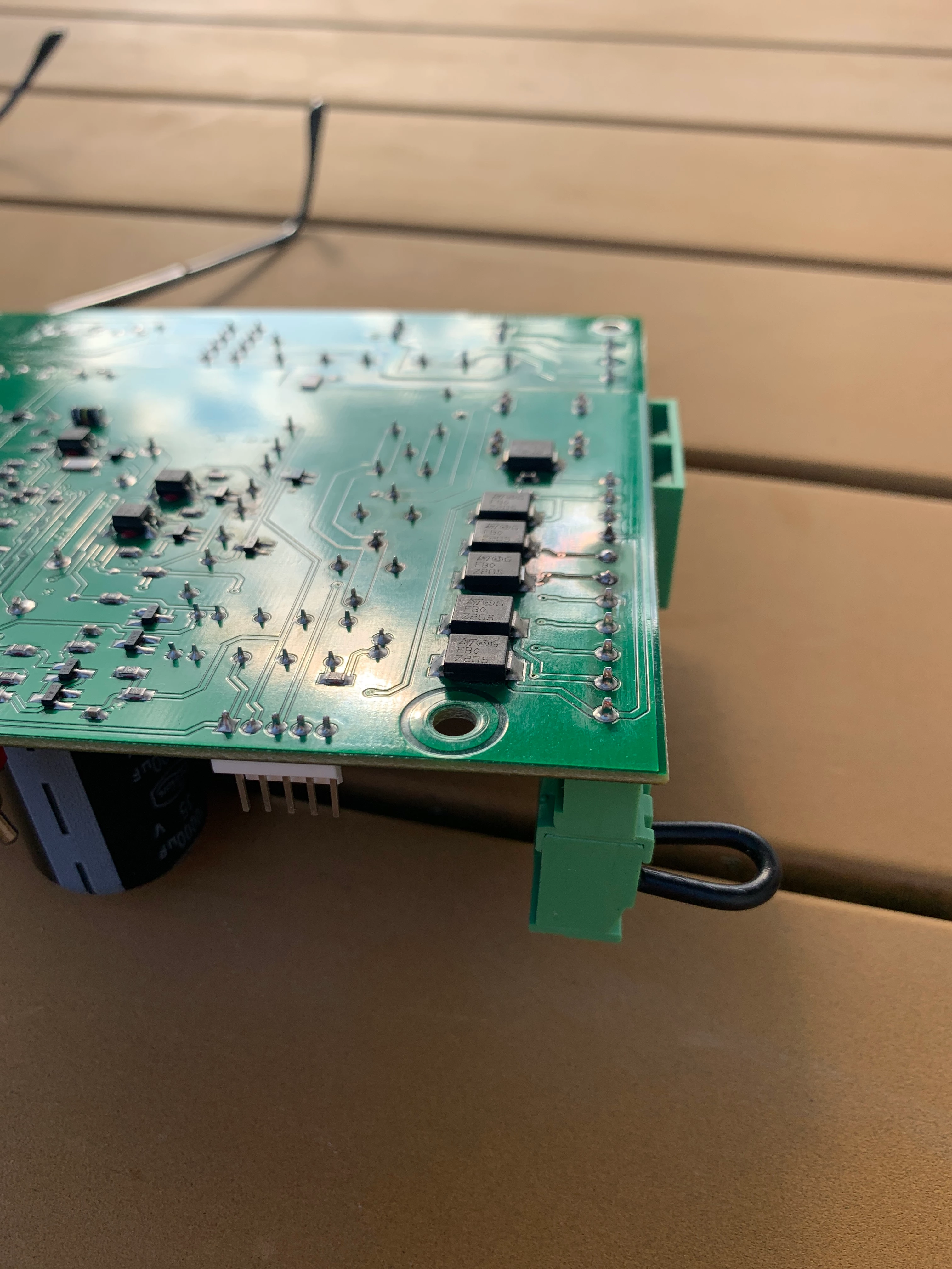

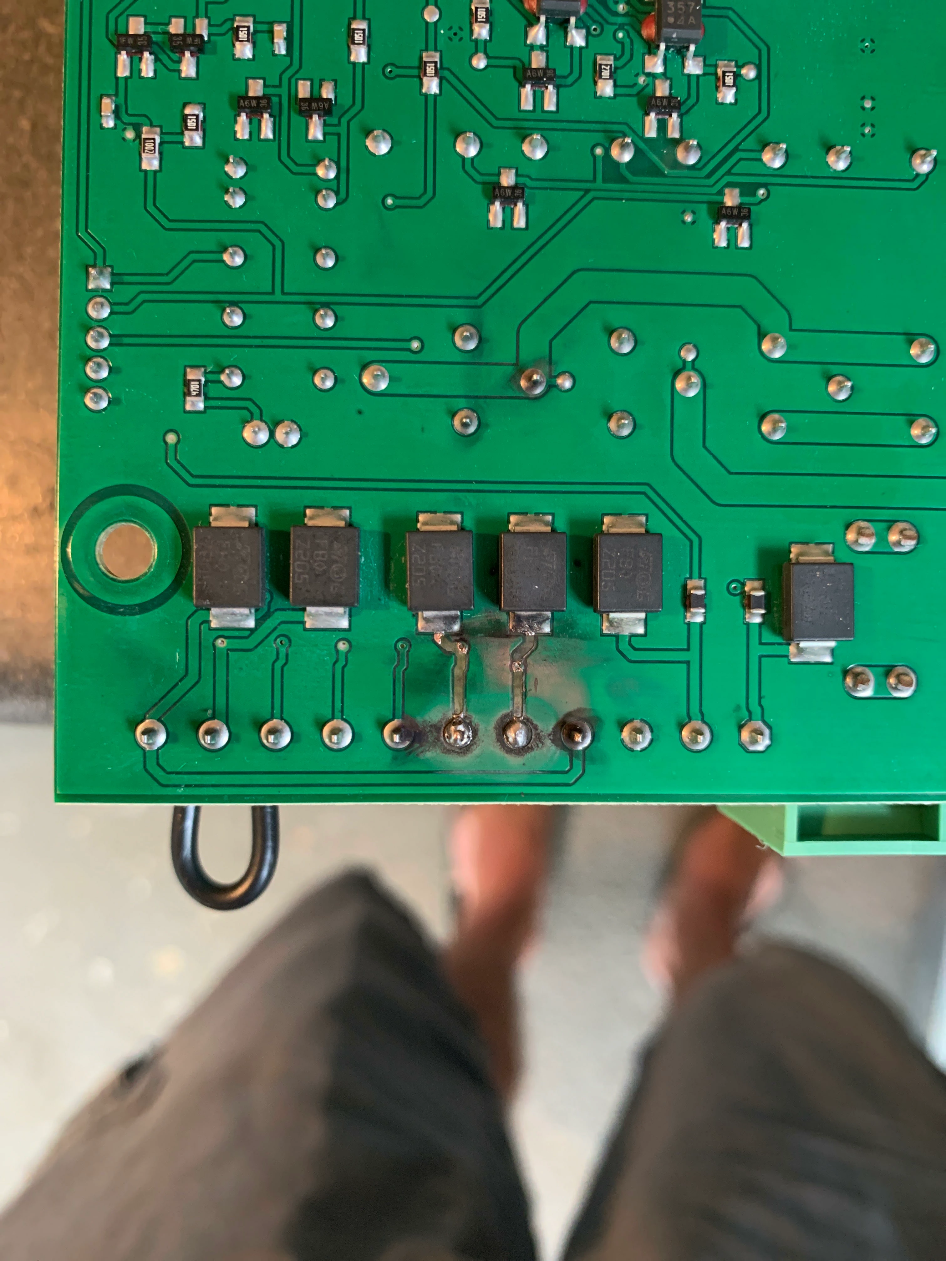

    regarding my model which one I have to take unidirectional ou bidirectional ? I put others picture of the item.
    Tesla DeLorean
    Guru
    Jul 6, 2021 4:02 PM UTC
    Might want to look at what actually failed there, diodes seem to have conducted more than the traces

    I hope no but I will change the diode and see if the relay behind is ok or not.
    This is a card for a swimming pool roller shutter and in manual position I can open and close the shutter, I cross the fingers :anxious_face_with_sweat:
