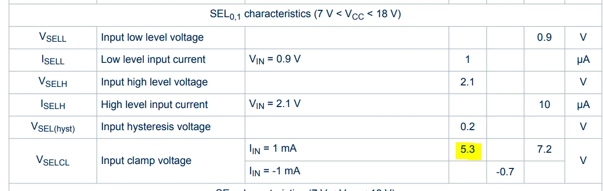

5V. Above that they're going to start clamping the voltage. See Table 9 in the datasheet.
