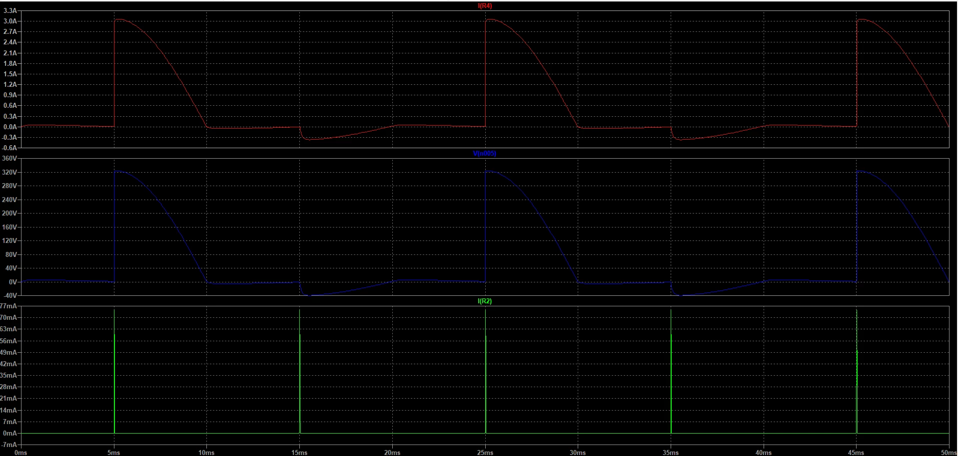

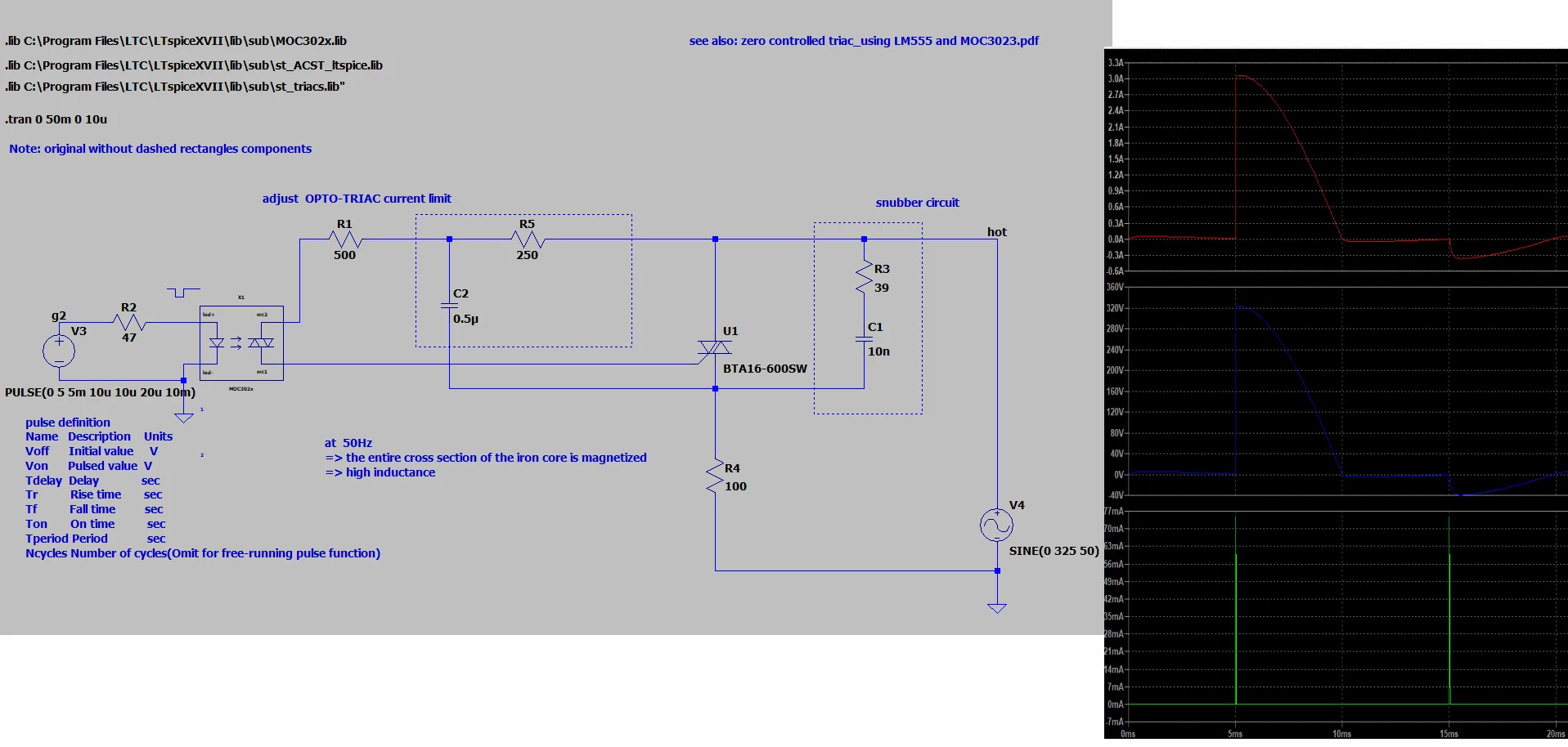

we use the triac BTA/BTB16 for 1 Phase Control of a Feeder ( 230 VAC, 50 Hz). attached the LTspice- Simulation. Question: why is the current not symetric ? Bernd
  • May 27, 2020
  • 0 replies
  • 810 views

TEXT 664 680 Left 2 !.tran 0 50m 0 10u
TEXT 664 576 Left 2 !.lib C:\\Program Files\\LTC\\LTspiceXVII\\lib\\sub\\st_ACST_ltspice.lib
TEXT 2344 840 Left 2 ;snubber circuit
TEXT 704 1264 Left 2 ;pulse definition \nName Description Units \nVoff Initial value V \nVon Pulsed value V \nTdelay Delay sec \nTr Rise time sec \nTf Fall time sec \nTon On time sec \nTperiod Period sec \nNcycles Number of cycles(Omit for free-running pulse function)
TEXT 1048 1240 Right 0 ;1
TEXT 1048 1328 Right 0 ;2
TEXT 1160 832 Left 2 ;adjust OPTO-TRIAC current limit
TEXT 664 616 Left 2 !.lib C:\\Program Files\\LTC\\LTspiceXVII\\lib\\sub\\st_triacs.lib"
TEXT 1984 528 Left 2 ;see also: zero controlled triac_using LM555 and MOC3023.pdf
TEXT 672 736 Left 2 ;Note: original without dashed rectangles components
TEXT 1280 1304 Left 2 ;bei 50Hz\n=> der gesamte Querschnitt des Eisenkerns magnetisiert\n=> hohe Induktivität
TEXT 664 528 Left 2 !.lib C:\\Program Files\\LTC\\LTspiceXVII\\lib\\sub\\MOC302x.lib
