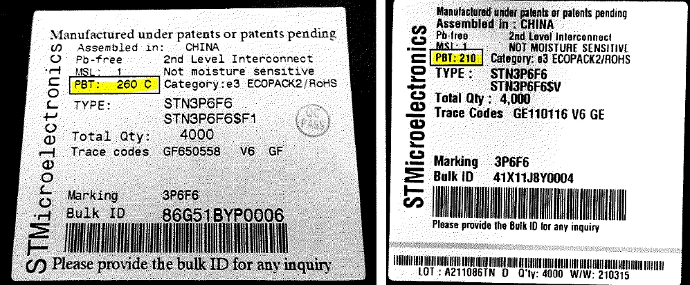

we have 2 STM labels for STN3P6F6, which PBT difference, 260 C and 210 C, would you help to check what is difference or STM has PCN to changed this information, thanks,

The technical parameters of the components are absolutely and completely identical, only the peak body temperature has been increased from 210DEGC to 260DEGC in the devices with the designation STN3P6F6$F1.

Hi Peter,
Thanks for your explanation. However, we still have some confused. Would you check again is it possible the PBT was typo error at STM mfg label?? It is because the PBT should be 260C or 220C at the JEDEC J-STD-020 accordingly.
Thanks and awaiting for your reply, thanks for your cooperation,

No, it was not a typo.
