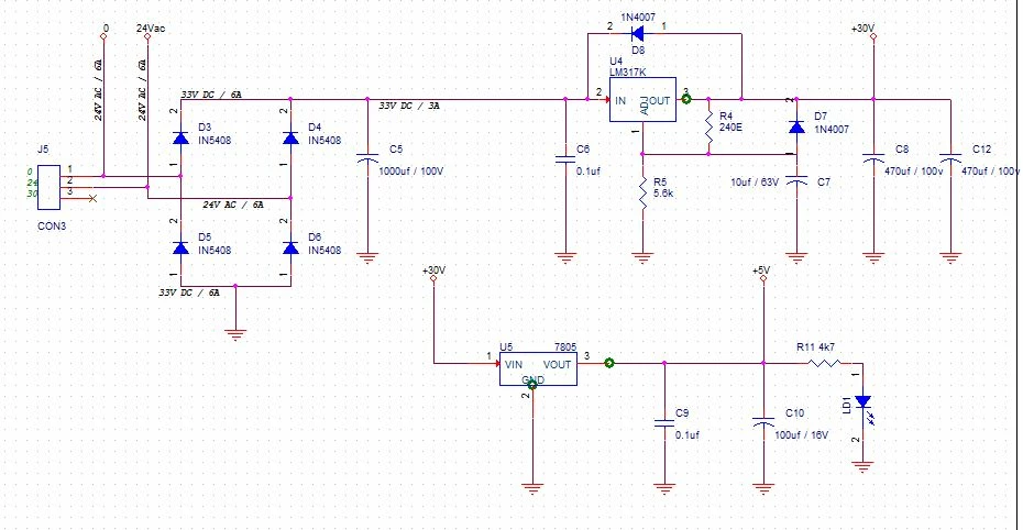

We are using L7805CV , Input voltage = 30V output expected = 5V with 100mA of current requirement But we are getting 7.5V, the L7805 which is not correct,may know the reason?
Input voltage = 30V
according to datasheet input voltage is 35V
Current supplied to the micro controller board and output driver IC,
Still 7805CV not able to deliver the 5V
Please find the attached circuit for the refernce and let us know
please let me know why this circuit is not working or let us know the input voltage limitation of the 7805CV,
