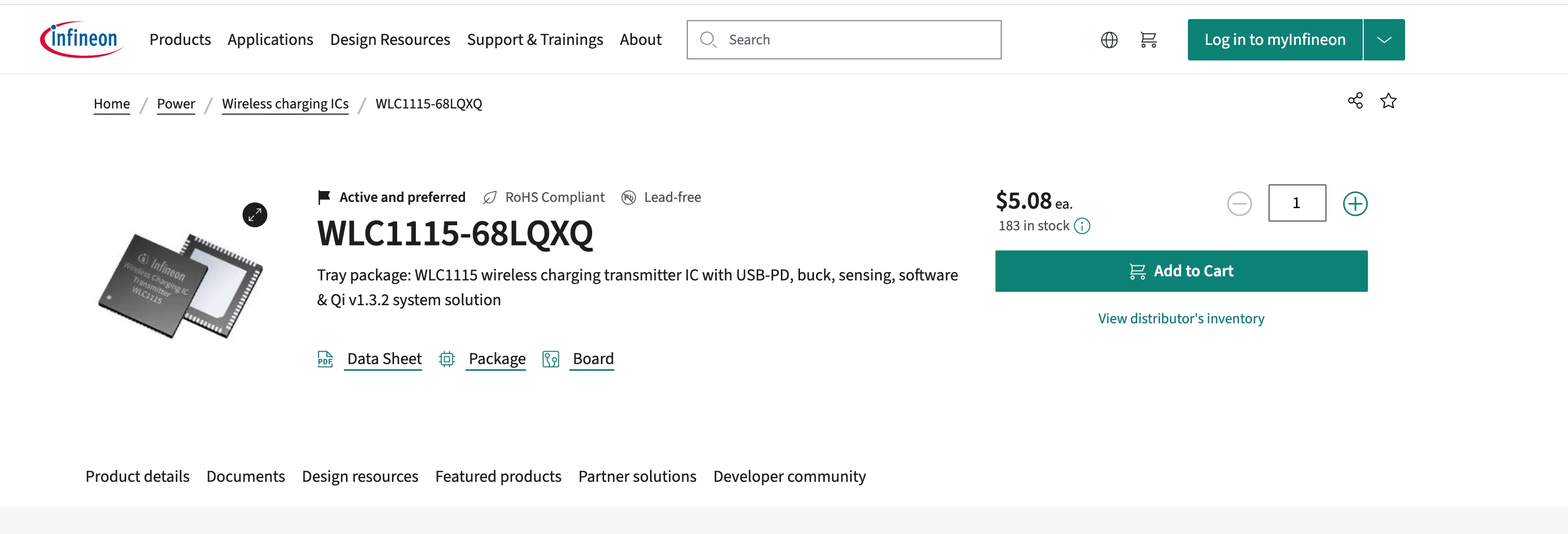

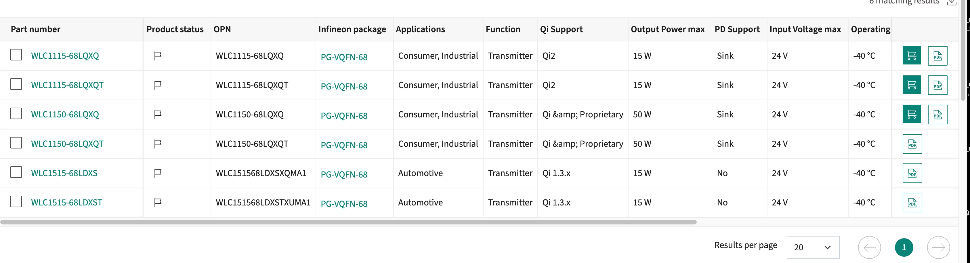

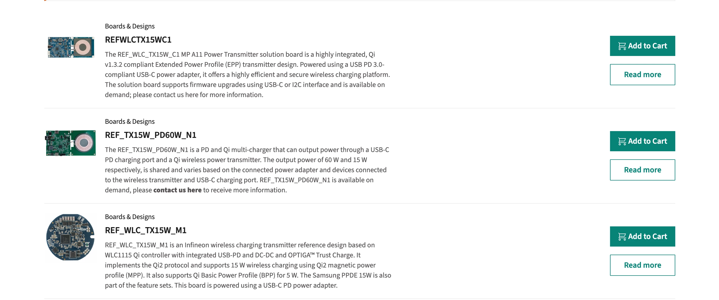

Aug 11, 2025 12:34 AM UTC
What about from Infineon?
Looks like they have Qi 2.0 and dev kits available
WLC1115

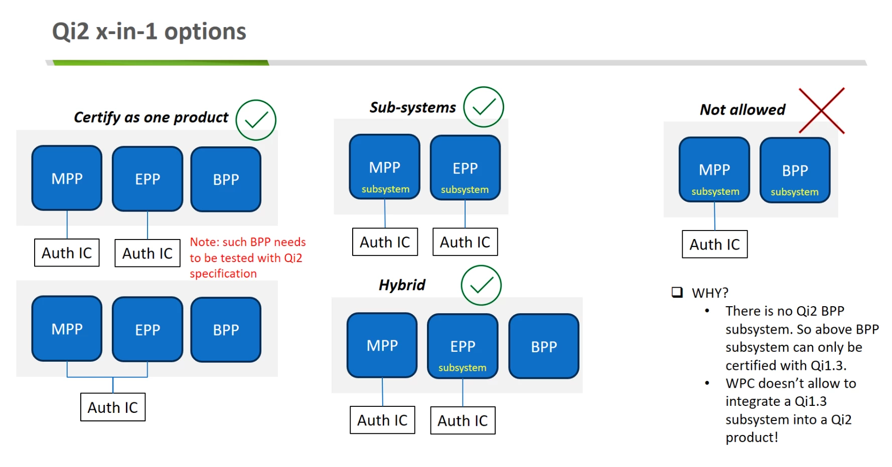

Aug 11, 2025 12:45 AM UTC
So I don't believe they are only certifying 2.x at this time. You just can't mix BPP and MPP.
You can mix BPP and EPP.

Aug 11, 2025 1:27 AM UTC
Indeed, WLC1115 may be the solution!
I saw it before but was scared off by the authentication *** (needs another chip?). Hopefully it's optional.
