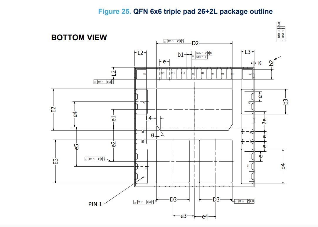

I'm looking for a footprint or land pattern to use for designing a PCB around the VNH9030AQ.  I'm sorry if I've overlooked it somewhere--can anyone point me in the right direction?

indeed the footprint is not currently included in the data sheet. However, the product website also has a tab CAD Resources where you can request the footprint from two partner providers.

For those also looking for this...the partner providers are unwilling to help until more information is available.
I've also been informed by ST support that there is no ETA for the information, and that "if ST did not make it on the website then likely it will not be made".

see ds :
Its given here in detail, so just ...draw it . (If no ready made footprint in your prog avail.)
