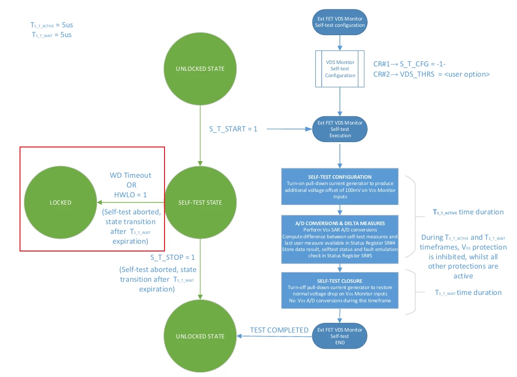

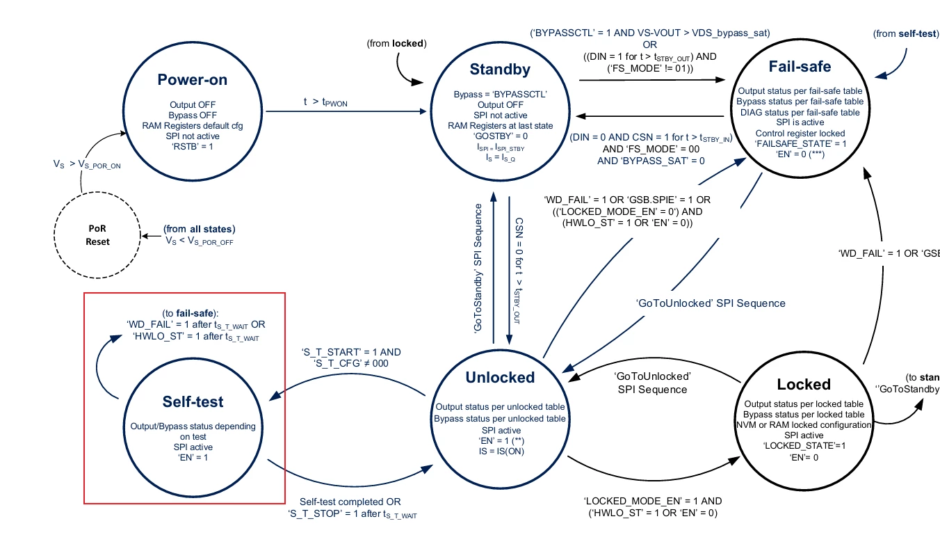

VNF1248 state switching
  • August 10, 2026
  • 0 replies
  • 40 views
There are several contradictory results in the Spec regarding the mode transition after self test aborted, as shown in the following figure,Which conclusion is correct
