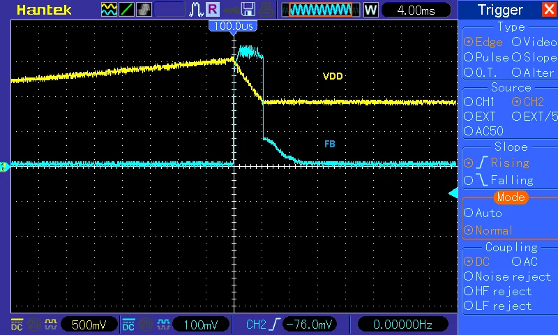

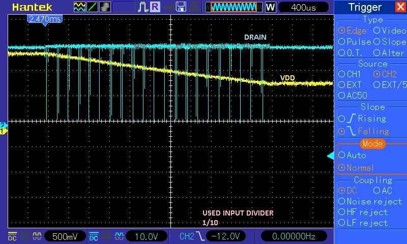

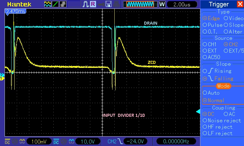

Hello, community,
I try to  develop power supply  based on VIPER35L, but  it  runs only in burst mode never reaching steady regulation. I have made almost a copy  of  STEVAL-ISA171V1, except of transformer, which was made by myself. According application note  AN4812.
  What might be the culprit?  Are  transformer data  correct in it ?  I mean ratio  8:1:1. Isn’t  it too  small to power  self?
 Several oscilloscope  snapshots are taken.  Any advice appreciated.

Welcome ​@Bnx, to the community!
The most likely issue is not just the 8:1:1 ratio, but that the auxiliary winding is not providing enough stable VDD supply. The controller then hits UVLO, falls into burst mode, and never reaches steady regulation.
Please check first:
  • does the VDD waveform clearly stay above the UVLO threshold (8.5V)?
  • Aux winding polarity and rectifier orientation
  • Transformer primary inductance and demagnetisation timing
  • ZCD waveform on the drain
So, 8:1:1 is not automatically too small, but the transformer design and polarity are critical.
Hope that helps?
