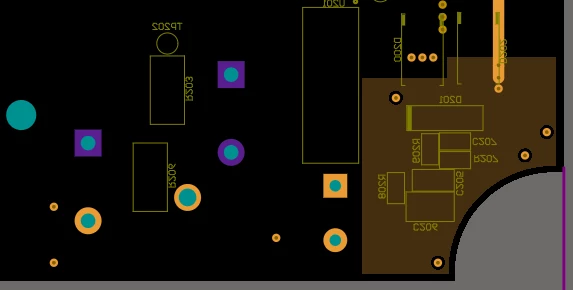

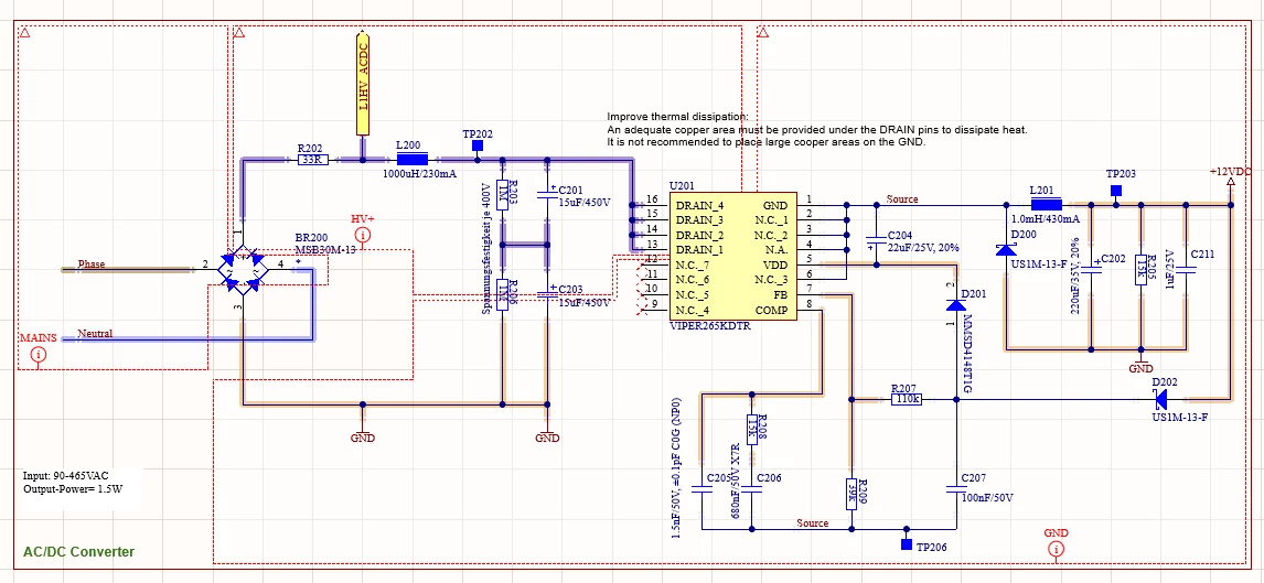

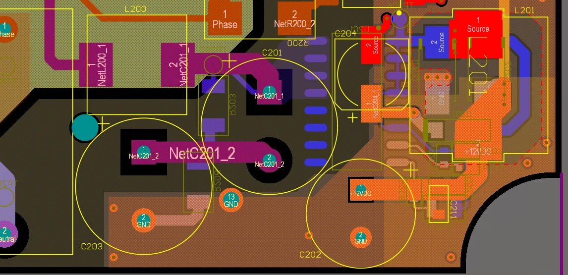

I have a problem with the Viper265K. I copied the basic circuit from the eval board (STEVAL-VP26K01B).
The desired input voltage range is 90-465VAC 50/60Hz
Output voltage 12V
Output current ~0.1A
Currently, I have a resistive load connected to verify the power supply. Unfortunately, the output voltage collapses at higher input voltages >420VAC or it just switches on/off very briefly.
The coil L201 is a 7447714102 with I: 0.43A / Isat: 0.55A
When I replace L201 with the inductor from the eval board, the maximum input voltage is still not higher.
But the eval board works perfectly with 12V and the maximum input voltage as declared by ST.
What am I doing wrong?
Bottom Layout

Could you share a full schematic and board layout please if acceptable?

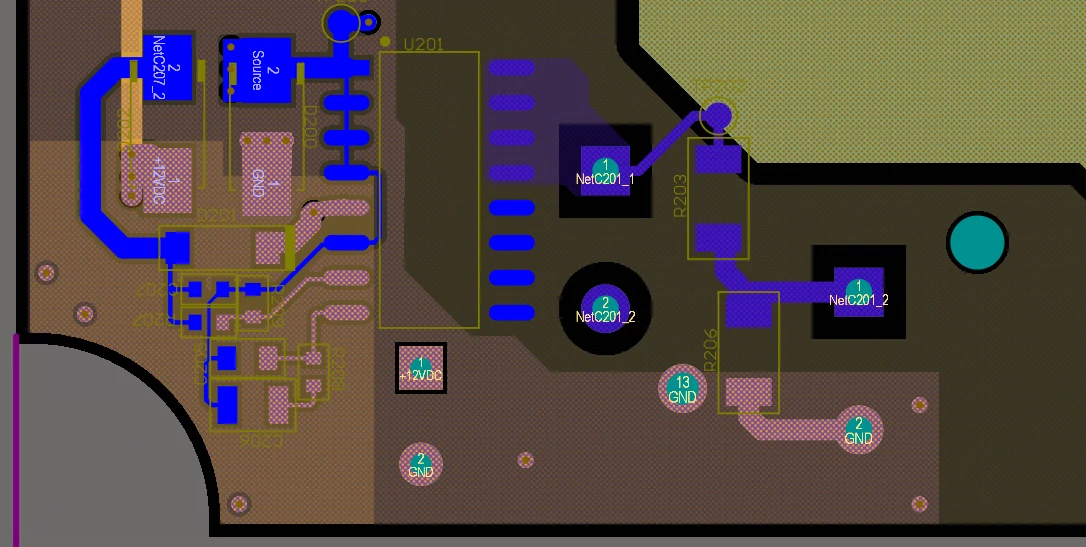

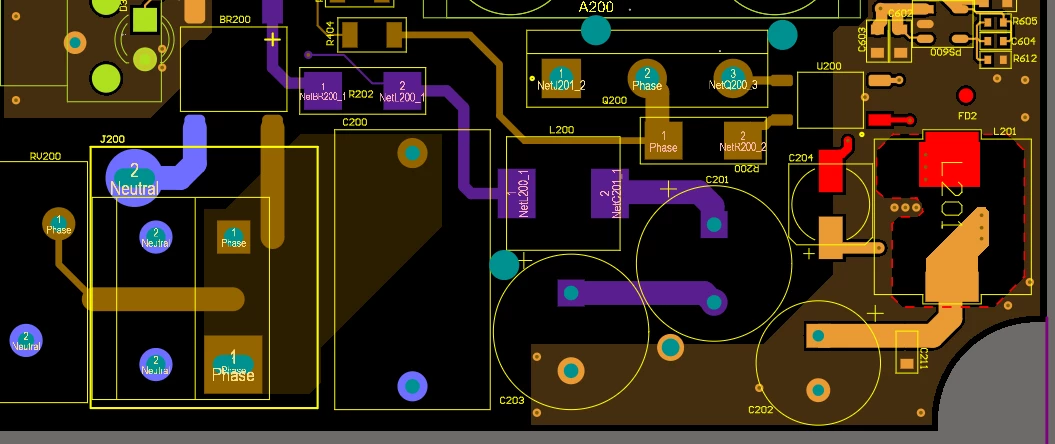

I would be inclined to believe the problem, or at least a problem, is that D200 is placed directly underneath the power inductor (L201) while its high voltage switching traces run very near to your feedback lines, this can create severe capacitive and magnetic coupling. At high input voltages arrangement may act like an miniature antenna, injecting electrical noise spikes directly into the Viper's feedback pin and tricking the controller into constantly shutting down to protect itself.
Is this a 2 or 4 layer board? Looks like 2 to me.
Philipp_KAuthor
Oct 20, 2026 12:48 PM UTC

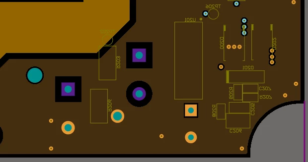

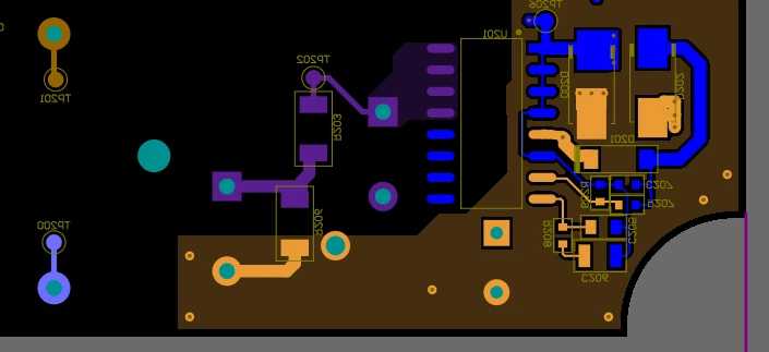

Yes, the D200 is just below the L201. It's a 4-layer PCB.
I also added some extra pictures for a better understanding of the layer structure.
TOP, plane GND
Midlayer 1  ; plane 12V
Midlayer 2 ; plane GND
Bottom ; plane GND

Oct 20, 2026 1:22 PM UTC
Looking at your layout and 4 layer stackup, I think your issue is likely high-voltage noise coupling into the feedback loop.
The cathode/switching node of D200 experiences massive 600V+ voltage swings at 60 kHz. Because the diode is stacked directly underneath the L201 inductor, its high-voltage switching traces are capacitively coupling these sharp transients straight through the inner board layers and into the adjacent feedback lines. Effectively its acting like a capacitor or more accurately a parasitic capacitor .This contaminates your feedback reference, tricking the Viper into a continuous protection shutdown.
If you can spare a board to test this theory:
Use a stanley knife to carefully cut the trace to D200 on the board, and temporarily solder D200 using small wires completely away from the inductor and feedback lines. If the circuit suddenly works at 465VAC, your layout coupling is the culprit.

Philipp_KAuthor
Oct 21, 2026 1:38 PM UTC
Today we desoldered the D200 and tested it a bit offset with 15mm and 60mm connection wires. Unfortunately, it didn’t help at all; we could NOT increase the maximum input voltage.
We also tried measuring the pulse time, but we’re already at 380ns, which is below the minimum on-time from 480ns. unfortunately, I can’t successfully reproduce this in eDesignSuite either. Also, the Evalboard can’t be simulated in eDesignSuite. There are also errors due to too short ON time.
Oct 21, 2026 2:28 PM UTC
I feel silly for not spotting this issue sooner! I would change your 1.0mH inductor to a 2.2 mH inductor. This means it will ramp current more than twice as slow as the original inductor, stretching the pulse time safely past minimum on time requirement.
If this does not work then I am at a loss. Though I would move your diode position in future boards as mounting switching components directly under inductors is always bad news.
