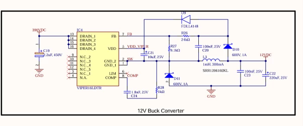

Hello ST Community,
We are using the VIPER16LDTR in a non-isolated buck converter to generate 12VDC from a 325VDC rectified bus. The input is 230VAC from a Variac, rectified to approximately 325VDC through our input rectification stage. The circuit follows the standard buck topology from VIPER16 datasheet Figure 17. Operating conditions: Vin = 325VDC, Vout = 12V, Iout = approximately 250mA, fsw = 60kHz (VIPER16L type confirmed with differential probe).
What we have verified as healthy:
  • DRAIN pins 13-16: 325VDC present and confirmed
  • VDD pin 5 (via C21, 10uF): 12V present — internal HV startup source working
  • SW node pin 2: 60kHz switching waveform confirmed with differential oscilloscope probe
  • D9 (FDLL4148): forward drop confirmed, correct orientation
  • D10, D11 (600V/1A): both healthy in diode mode
  • L3 (1mH, SRR1206102KL): DCR = 0.25Ω, solder joints inspected and reflowed, continuity confirmed
  • C22 (220uF, 25V output cap): 1.4MΩ to GND — no leakage, no short
  • 12V rail to GND (load side): 4.5kΩ — no downstream short
  • FB divider (R26/R27): reading 500mV correctly reflecting actual output via divider ratio
The problem:
Despite the IC switching correctly at 60kHz and VDD being present at 12V, we are observing the following faults together:
  • COMP pin (pin 8) is permanently stuck at 0.75V — well below the VCOMPL burst mode threshold of 1.1V typical per datasheet Table 8
  • Duty cycle is very low — the ON pulse on the SW node is extremely narrow, much less than the expected ~3.7% (12V/325V). The IC appears to be firing only brief occasional pulses rather than sustained PWM
  • Output (C22) is stuck at 500mV and never builds up to 12V
The IC is not in a fault latch or thermal shutdown — it is actively producing switching pulses at 60kHz on every power cycle. The output simply never rises despite switching being present.
We believe the very low duty cycle and the COMP being stuck at 0.75V are related — with COMP below VCOMPL the IC enters burst mode per the datasheet, which suppresses duty cycle to near zero and starves the output. However we cannot determine what is causing COMP to be stuck below the burst mode threshold in the first place, since all external components have been verified and replaced.
What we have tried:
  • Replaced IC4 (VIPER16LDTR) twice with new parts — identical symptoms on every replacement
  • Replaced all surrounding passive components (R26, R27, R28, C20, C21, C22, C23, C24, D9, D10, D11, L3) — identical symptoms persist
  • Inspected and reflowed all solder joints — no change
  • Confirmed no short on output or load side
  • Confirmed switching frequency with differential oscilloscope probe — 60kHz present on SW node
Additional observation:
We have two boards built from the identical schematic and BOM. One board works correctly and produces 12V with normal duty cycle. The other board shows the above fault — very low duty cycle, COMP at 0.75V, output at 500mV. Both boards have been measured and all component values are within tolerance. We cannot explain why two identical boards built from the same components and schematic behave differently.
Our compensation network values:
  • R28 (Rc) = 1kΩ
  • C24 (Cc) = 1.8nF
  • No Cp fitted
Questions for ST:
  1. With COMP stuck at 0.75V (below VCOMPL = 1.1V typical), very low duty cycle, and the IC confirmed switching at 60kHz with VDD present at 12V — what is the most likely root cause and what should we check next?
  2. Is there any internal IC condition — for example a protection latch, OTP event, or internal state — that could hold COMP below VCOMPL independently of the external compensation network, and that could persist across power cycles?
  3. Could the LIM pin (pin 6) being left floating cause any startup or COMP behavior issue in a buck topology? Our load is 250mA which is well below the default IDlim of 0.4A.
  4. Are our compensation network values (R28 = 1kΩ, C24 = 1.8nF) suitable for this operating point (Vin = 325VDC, Vout = 12V, Iout = 250mA, fsw = 60kHz)? Could wrong compensation values cause COMP to be permanently suppressed below the burst mode threshold, resulting in very low duty cycle and output stuck at 500mV?
  5. Is it possible for the IC to switch at 60kHz on the SW node while simultaneously being in burst mode — or does burst mode completely stop all switching? We are seeing 60kHz on the scope but the duty cycle appears very low, which is causing some confusion in our diagnosis.
We are stuck on this issue and would greatly appreciate ST's guidance on what to investigate next. Any help is much appreciated.

Aug 4, 2026 7:14 AM UTC
Your double post had to be deleted repeatedly. ​@mƎALLEm had already asked you not to ask the same question multiple times.
I took a closer look at your problem and found that the schematics had apparently not been simulated before. Using the values in your schematics (L3, C24 and R28), the resulting Bode plot is very poor, with unsuitable values for phase margin of about 34° (target: 76°) and bandwidth of about 6kHz (target: 3.7kHz ±10%). You can try the following values: C24 = 130nF, R28 = 13kΩ, an additional Cp = 2nF (Cp to be connected between COMP and GND_1/2). Also check that your version of the SRR1206-102KL has a saturation current (not average current) of at least 500mA.

Aug 8, 2026 5:44 AM UTC
I probed the FB pin directly. Previously it was reading only ~0.5V, not the expected ~3.3V (internal reference level) it should regulate to.
After implementing the updated RC values you suggested by Peter BENSCH(C24 = 130nF, R28 = 13kΩ) on the problem board, FB is now reading ~3.219V — close to the expected reference — but the output is still not regulating correctly to 12V still the Output Stuck in 500mV. VDD_Viper pin getting 12V.
On our second (working) board, the exact same voltage divider ratio and RC compensation(C24 = 1.8nF, R28 = 1kΩ)values produce a correct ~3.3V-equivalent at FB, and that board outputs a healthy 12V.
So now that FB is close to reference on the problem board too, could you clarify what might still be preventing the output from reaching 12V?

You should understand ​@Peter BENSCH gave you the fundamental knowledge, if Bode plot show your compensation network no good, your design may got big problem later, even damage all board. So even your “good” board you need change too.
You should looking for switch node waveform (SW pin) most like didn’t switching.

However, on the problem board, even after changing to the recommended C24 = 130nF and R28 = 13kΩ, I'm still not getting the expected 12V output. I confirmed on the SW pin (pin 2) that switching is present at 60kHz in both RC Network, consistent with the VIPER16L variant per the datasheet.
Since switching is confirmed but output is still not building up correctly even with the corrected RC network, could you please advise what else I should check next? I'll continue checking and update with findings.

If feedback phase change, at least output should impact, still stuck at 0.5V is weird.
You noticed early:
Why these two different values? (May not big issue, no short)
Could you turn off power, measure L3 resistance. Compare with good board.
For the SW node 60K pulse, is change compensation network values impact duty cycle (For bad board)?

BTW, ​@Peter BENSCH suggestion, add one more pole - add one capacitor between COMP and GND 1,2.
This should make phase more smooth.
