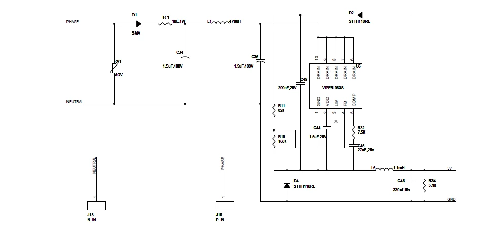

viper06 buck mode to generate 3.3V. output voltage =1.24V
I use the viper06HS to generate +3.3V. i follow the reference design provided by eDesignSuite.
When i turn on my system. the viper06HS provide 1.24V
do you idea?
I attach my schematic

    Peter BENSCH
    Aug 31, 2021 11:46 AM UTC
    The VIPER06HS is actually intended for isolated converters, but can also be used for non-isolated converters. Unfortunately you confused pin 1 (GND) with neutral, which leads to several errors:
    • C4.1 should not connect to L3.1, but to D4.2
    • C3.2 should not connect to D4.1, but to D4.2 as well
    • the capacitor between IC1.5 and D4.2 is missing (shown as Cp in eDesignSuite)

    LRoch.1
    Visitor II
    Aug 31, 2021 1:21 PM UTC
    I have made the modification on my design. but i have 1.5V on the output

    LRoch.1
    Visitor II
    Aug 31, 2021 1:54 PM UTC
    i update my schematic. for the layout . i put some wires on PCB
    Peter BENSCH
    Aug 31, 2021 2:31 PM UTC
    Hmm, just wires on a PCB doesn't sound like optimal wiring for a switching regulator.
    Please make sure the FB wire is as short as possible and not below the inductors.
    Also minimize the length of the wires between pin 1 (GND), D4.1 and L3.1. The connection between D4.2, C6 (-) and the output should also be minimized.
    BTW: I forgot to mention one additional error - the compensation network C5 and C? should not be connected to D4.1, but to D4.2.

    LRoch.1
    Visitor II
    Aug 31, 2021 2:53 PM UTC
    I know the wire is not optimal but for the moment I try to solve my problem.
    the feedback Wire is near viper on my design.
    it is strange that the modifications do not correspond with the reference diagram
    for example, i have the reference design of steval-blueplug on the schematic is very different0693W00000DllRoQAJ.png

    LROCH.11
    LROCH.11AuthorBest answer
    Sep 2, 2021 12:11 PM UTC
    I have modify my first schematic to generate +4V with VIPER06.
    I have changed the value R2 by 100K and i have add a resistor of 470K to D4.1 and now it is works.
