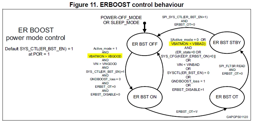

  3. VBATMON is used for power-up and power-down sequences, and ERBOOST enable.
  4. VBATMON is used to enable ERBOOST regulator
    and ISOK function
    and ISOK function
     It is also used to alarm the MCU in order to guarantee the correct functionality of RSU function.

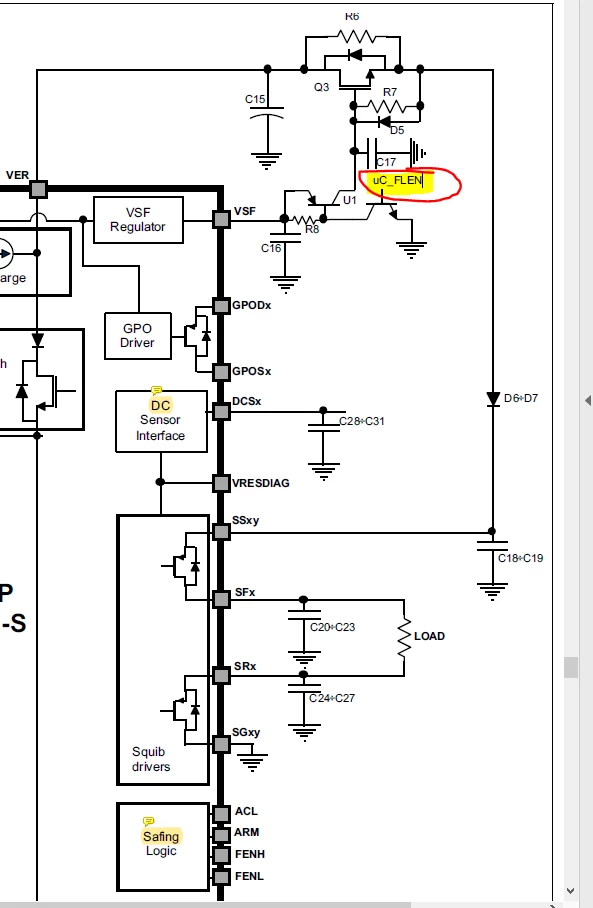

  • uC_FLEN:In the reference application diagram, I noticed that the uC_FLEN signal from the MCU appears to drive the gate of an N-channel FET in the safing path (related to the VSF-regulated supply). I would like to confirm:
    Is my understanding correct that uC_FLEN is a control signal from the MCU used to enable or disable the safing FET path (typically by pulling the gate low)?
    What is the recommended driving strategy from the MCU for this pin?

  • uC_FLEN: something just explained in the other answer; in any case, your understanding is correct.
    In automotive application, both L9678P and MCU elaborate the data from the sensors and must be in agreement to arm: L9678P will enable VSF regulator, MCU will drive uC_FLEN signal. Then, the MCU sends the commands to deploy via SPI.

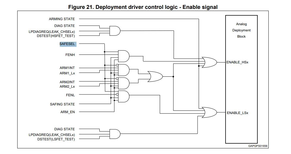

Jun 24, 2025 2:25 PM UTC
Dear @MJ_Pellegrini   and @ahsrabrifat  ,
Thank you both for your support and previous replies.
One more doubts as an application that does not use sensors, remote interfaces, or PSI5 input. Our use case involves triggering deployment logic solely based on MCU-driven signals, without relying on internal safing logic driven by sensor thresholds(we are not using in vehicle application).
Our Main Question:

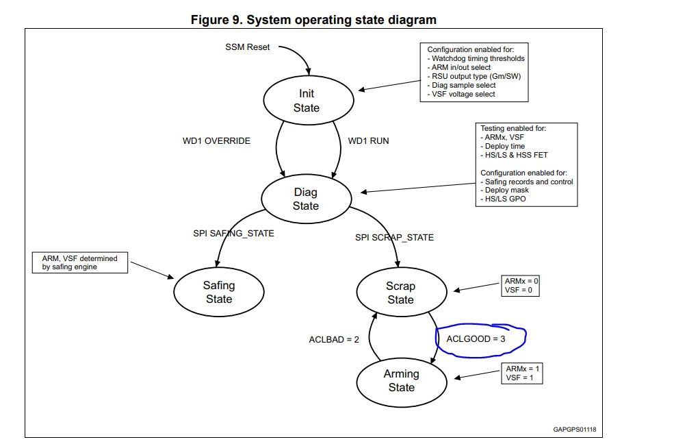

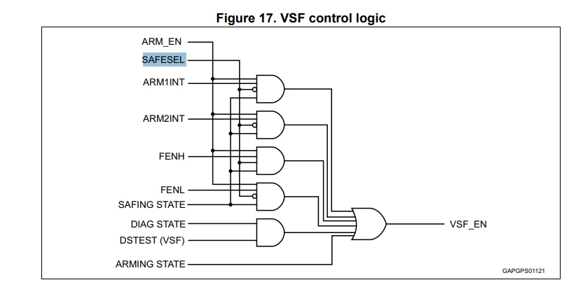

In order to reach the ARMING state and assert VSF_EN, as my understanding can we rely solely on:
  • ACL pin: 3 valid pulses (i.e., ACLGOOD = 3)
  • FENH pin: High
  • FENL pin: High
  • SPI SAFESEL = 1 (external safety logic)
Umesh_Kumar278_1-1750774237017.pngUmesh_Kumar278_2-1750774269633.pngUmesh_Kumar278_3-1750774285957.png
And skipping:
  • All SPI sensor data processing
  • All safing threshold evaluations
  • SPI safing record logic
Since no sensors ( because external event has in MCU and based on that  wanna to deploy )
 Expected Transition Path (No Sensors):
  1. System starts in INIT → DIAG
  2. MCU issues SPI command SAFING_STATE
  3. L9678P enters SAFING state
  4. MCU asserts:
    • ACL pulses (3x ACLGOOD vvalid)
    • FENH = 1, FENL = 0
    • SAFESSEL = 1
  5. Device transitions to ARMING state
  6. VSF_EN is asserted
Can you please confirm if this is the valid and complete minimal setup for entering the ARMING state when the internal sensor-driven safing logic is not used?
if so yes In this setup, is it necessary to map below pins with the MCU right?
Pin Name Purpose
ACLProvide 3 pulses → ACLGOOD = 3 to enter ARMING state
FENLPulled high by MCU to indicate external safing logic
FENHPulled high by MCU to indicate external safing logic
Thank you!

uC_FLENIn the reference schematic, uC_FLEN appears to be used as a GPIO from the MCU to control a FET in the VSF-powered safing path — is this correct? Could this function alternatively be driven by one of the L9678P’s GPO drivers to reduce MCU pin usage? (typically near U1 as shown in Figure 58)

  • uC_FLEN: in automotive application it is a signal driven by MCU to enable the switch placed between VSF regulator and the "Safing FET"; it is used for safety because in automotive application there is the need for a double confirmation by L9678P (VSF enabled when it moves in ARMING state) and by MCU (uC_FLEN signal) to enable the Safing FET (also called third FET in some applications)
