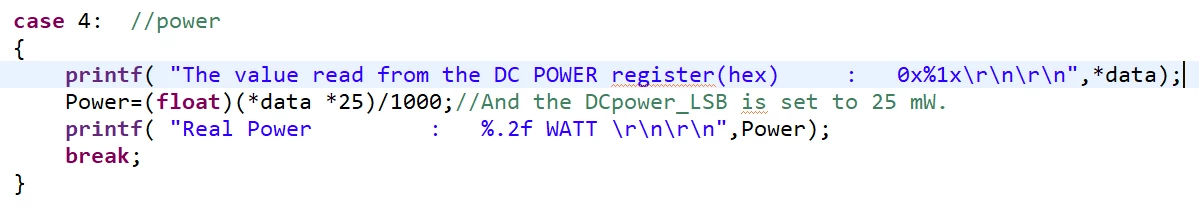

i bought a TSC1641 evaluation board, I can't read the power information from the DC power register. I can successfully read shunt voltage, current, load voltage data.
the configuration is as follows:
Rshunt register value = 0x01F4; the shunt resistance on my semim development
board is 5 mili ohms.(decimal=500).
configration register value = 0x0037; conversion time 1024 µs (default),
7h: shunt and load voltage, continuous mode (default).
I check the FLAG register data zeroth (CVNF) bit to see if the data is ready,
but regardless of this, I do a reading at any time.does this cause problems
with reading dc power information?

Print the value you're actually getting from the register - maybe the problem is in your calculation?
Correction:
What you're printing here is somehow arriving via a pointer - have you checked the point at which it's actually read from the chip?
Please use this button to properly post source code - rather than a screenshot:
https://community.st.com/t5/community-guidelines/how-to-write-your-question-to-maximize-your-chances-to-find-a/ta-p/575228

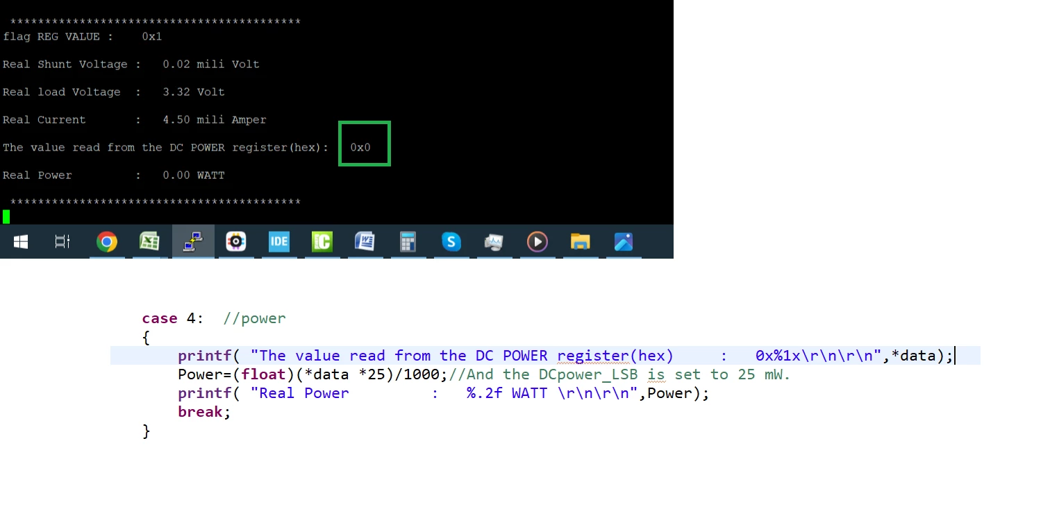

the decimal value I got from the recording is zero. therefore, the result of the multiplication used from the calculation of the actual power is also zero

I am printing the value I read from the recording on the screen. the value returns as zero.
