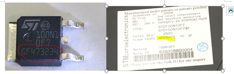

Trace code for STD100N107F7 our IQC team would like to know that why the trace code is different between label and component Text ,
0693W00000VOfxVQAT.pngTrace code for STD100N107F7
our IQC team would like to know that why the trace code is different between label and component Text , please see the attached
and also could you please let me know the date code of this batch .
Thank you so much

    This is obviously an internal problem that we still need to get to the bottom of.
    The trace code GF473234 on your STD100N10F7 is correct, i.e. date code 234 = 2022, week 34. However, someone accidentally mixed up the two groups of 3 digits on the label, i.e. 473 and 234. You can therefore assume that everything is in order and only the label was printed incorrectly.
    Does it answer your question?
    Regards
    /Peter

    Hi, @Peter BENSCH​ :
    Yes, it's clear to me now, Thank you so much .:grinning_face:
