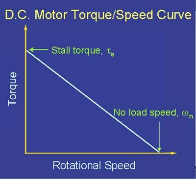

Hi @Cristiana SCARAMEL​  yes Now i get it. It is important to also state that for the purposes of motor control, the operating point actually shifts across different torque speed characteristic curves. This is true especially if the terminal voltage between two phases is modulated -- and that was what I had in my project. The speed controller modulates the output voltage between two phases of my inverter to get my BLDC motor to set-point speed.
So basically, the torque-speed curve changes as the voltage changes from 0 to DC-link voltage. So, the DC link voltage sets the maximum torque speed curve i.e the maximum achievable speed (no-load speed) and torque(stall torque). Therefore, it explains why regardless of the amount of current I supplied to my system, I just could not get it to a speed higher than the no-load speed set by the DC-link voltage.
Also, there is a more complex but simple relationship between the voltage, current, torque and speed like you said. When driven by a speed controller, especially if the speed controller has an output current saturation limit, sometimes it would not be able to achieve the setpoint speed even though it is less than the no-load speed determined by the DC-link voltage. So increasing the output current saturation limit can make the motor achieve the setpoint speed.

Muhammed Güler
Senior III
Nov 19, 2021 6:01 AM UTC
Engine speed and torque are inversely proportional. You cannot increase both at the same time.0693W00000GY7vBQAT.jpg
BoboyeOkeya
Nov 19, 2021 11:18 AM UTC
Okay that makes sense looking at the relationship between power, torque and speed.
But does that mean that if I apply a certain load torque on the motor’s shaft. Then the maximum speed I can get is fixed at that operating point determined by the load torque?
I hope you understand my question. If not let me rephrase.
Let’s say I have the torque-speed curve of my motor. Now if I apply a certain constant load torque. Then the load torque intersects the torque speed curve at a certain point which should give the corresponding speed. So does that mean that given that applied load torque, I won’t be able to exceed that corresponding speed?
Cristiana SCARAMEL
Dec 1, 2021 8:54 AM UTC
Hi @BoboyeOkeya​
I confirm that your assumptions are correct.
In the end the concept is that each motor has a relationship between voltage, current and specific torque.
Regardless of the range that is able to manage the inverter, you will never exceed the physical limit given by the characteristics of the motor.
