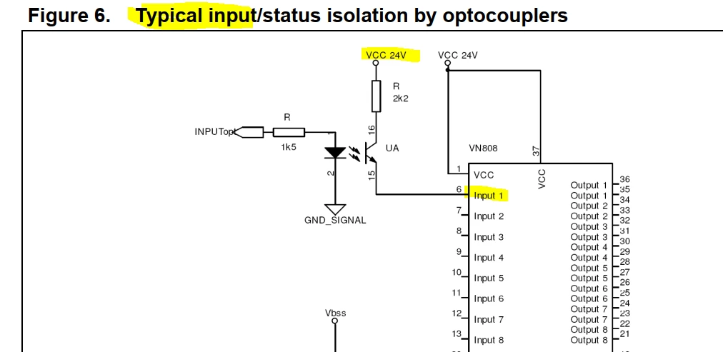

the vn808 device has a wrong datasheet which has a conflict with the app. note (AN2208) regarding to Vin rated voltage, although what should i do with the not connected pins ?

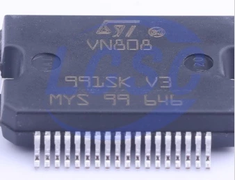

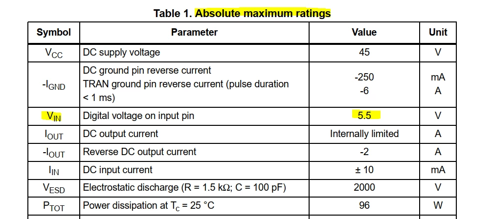

i'm working on a project uses this device (VN808_attached exact photo of the device i have) and in the datasheets carries a name of (VN808CM-32-E) i found in the absolute maximum rating table that Vin max is 5V (attached photo) in the other-hand i found in the app note #AN2208 that they put 24V on the Vin pins (attached photo) .so can you help me with this problem?
although i wanted to know the best connection for the not connected pins in the package should i connect them to VCC or GND ??

i was wrong with the datasheet , there was many versions of the device.
i still need to know the best connection of the NC (not connected) pins .
