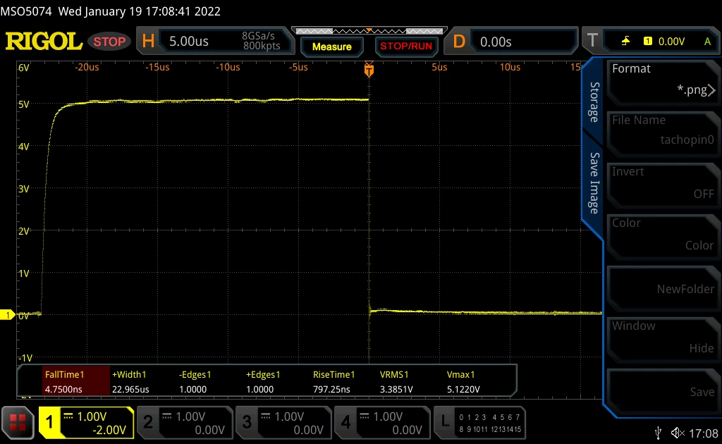

0693W00000JMrjYQAT.pngBased on the datasheet of Eval6235q (https://www.st.com/resource/en/data_brief/eval6235q.pdf) pg 4, Rpulse is given as 47k and Cpulse is given as 10n which I should get 282microseconds for tpulse. However, I couldn't get the value during my measurement, instead i only got 22.96 microseconds as shown in the picture. May I know what could be the reason?
Cristiana SCARAMEL
Jan 24, 2022 12:57 PM UTC
I confirm that with the RC network of 47kOhm and 10 nF you should get a tpulse of about 280 us.
Are you measuring the pulse connecting the probe directly on the TACHO pin (only with the pull-up resistor connected to VDD)?
Could you check if the pulse is correctly synchronized with the H1 signal?

Jan 24, 2022 4:26 PM UTC
Yes, I use the TACHO pin from J8 and it is correctly synchronized with H1 signal. Besides, I have added a 0.1 uF capacitor parrallel to the '10 nF' and I got 2.88 ms at the TACHO pin. With this result, I believe the capacitor C11 on the Eval6235Q R1.1 wasn't 10 nF, but only 2 - 4nF.
