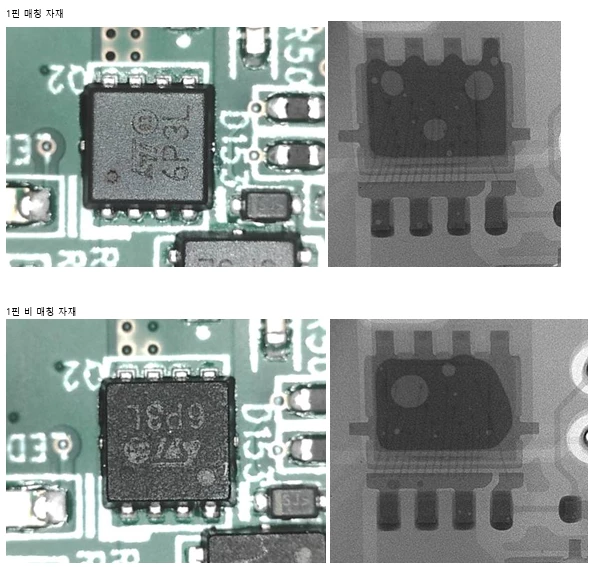

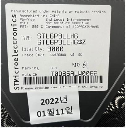

The location of dot for No.1 on the surface of the product is different.Seems to have markings are rotated 90 degrees differently from existing products. Is there anything special about the production lot marked on the label below?
