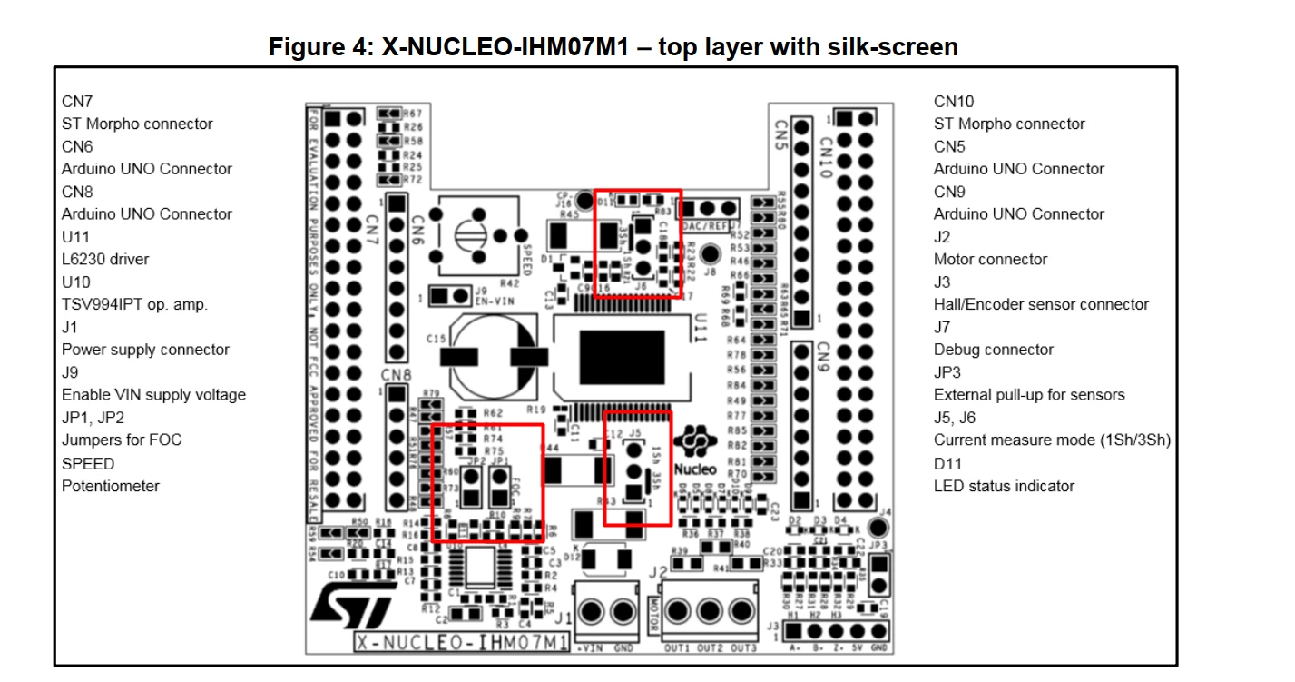

I try to flash the example image which is located at the following path
"STM32CubeExpansion_SPN8_V1.0.1\Projects\Multi\Examples\MotorControl\Src"
to development board and using six-step to start motor
but the motor doesn't startup , check the failure reason is startup failure
Doex enveryone knows how to run this example​?
thanks
I use
1. "nucleo f302r8" as the development board
2 "X-NUCLEO-IHM08M1" as the power board
3 " BR2804-1700Kv-1" as the motor

For six step control please check the next jumper settings:
  • JP1 open,
  • JP2 open
  • JP5 and JP6 on 1Sh position
All jumpers you can see on below picture (UM1943):

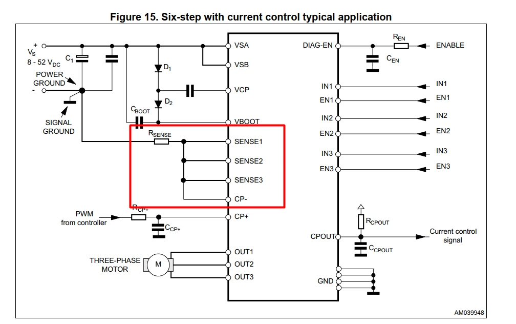

With above jumper settings, you make configuration for 1 shunt current reading (which is requested for six step motor control). You can find more information on L6230 datasheet.
Kind regards,
Dražen
