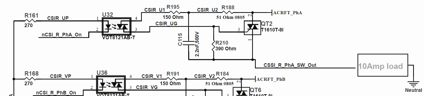

I apply three phases at 115vac, 400hz.
I apply a 10A load. I turn on the Opto-Triac (VOT8121AB), and current runs thru the Triac under test(TUT) (T1610T-8i) and ac voltage appears at the output (ex; see CSSI_R_PhaA_Out, loc=A5, of Attached schematic “8440-211-00-A.a3-pg9-SCH”)
I turn off the Opto-Triac, and the Output voltage and current both fall to approx. zero.
I turn on the Opto-Triac, and the Output voltage and current rise to 115vac, @10A. I monitor a current probe near the case of the TUT; At 40c, I can turn on and off the Opto-Triac, and the TUT turns on and off.
With the TUT on, I watch the temp rise. When it reaches 60C, The TUT does not turn off using the opto-Triac. When I drop AC into the TUT, for 100-200ms, the TUT turns off. TUT does turn on using the opto-Triac.
When the temperature near the TUT is allowed drop from 60 to 50c, the Opto-Triac turns the TUT on and off.
The resistance measured between pin 1 and 3 of the TUT, using a gate resistor of 390 ohm, (ex: R210, Loc=A2) =148 ohm.
Should I Try to lower the resistor from Gate to Output?
I placed a 385 ohm in parallel with the existing 390 ohm between pin 1 and 3 of the TUT. The resistance measured =107 ohm.
The temperature at which the TUT turned off increased 5c.
How small is it advisable to lower the resistance between pin 1 and 3 of the TUT? Using my present setup, I worry about the gate voltage I will generate if I go from 390 ohm to 75 ohm.

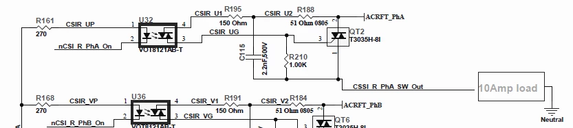

The solution:
Was:
Is:
T1610T-8i has a Di/Dt =
IH (1) IT = 500 mA  Max. 25 mA
dV/dt @vd_it = 67% x 600 V gate open Tj = 150 °C Min. 50V/us
(dl/dt)c (1) (dV/dt)c = 0.1 V/μs Tj = 150 °C  MIN.  5.4 A/ms
T3035H-8I has a Di/Dt =
IH (1) IT = 500 mA, gate open Max. 60 mA
dV/dt @vd_it= 536 V, gate open Tj= 150 °C                              Min. 2000 V/µs
 (dl/dt)c  @Without snubber network Tj= 150 °C                Min. 25 A/ms
