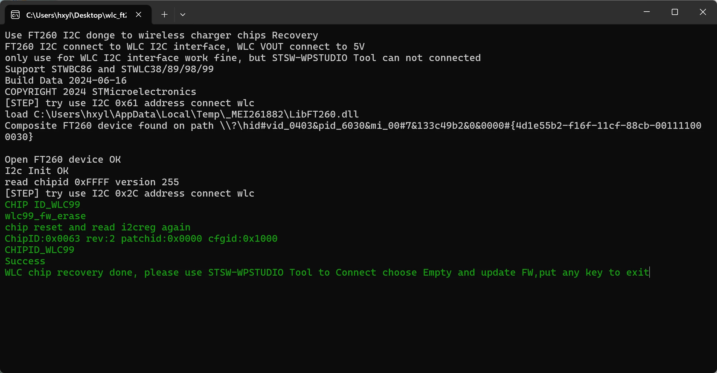

我的WLC99RX开发板无法连接到GUI,我下载了wlc_ft260_Recovery这个文件,我连接了STEVALUSBI2C,但是并没有用,可不可以给我一个详细的教程。
我还有一个问题是解释我的GUI界面似乎与开发板手册上的展示的不一样,GITHUB网页已经404,请问可以通过邮箱发给我与手册上展示一样的GUI软件吗,谢谢
Translation:
My WLC99RX development board cannot connect to the GUI. I downloaded the file wlc_ft260_Recovery and connected to STEVALUSBI2C, but it didn't work. Can you give me a detailed tutorial?
Another question is to explain that my GUI interface seems to be different from that shown in the development board manual. The GITHUB page has 404. Can you send me the same GUI software as shown in the manual via email? Thank you

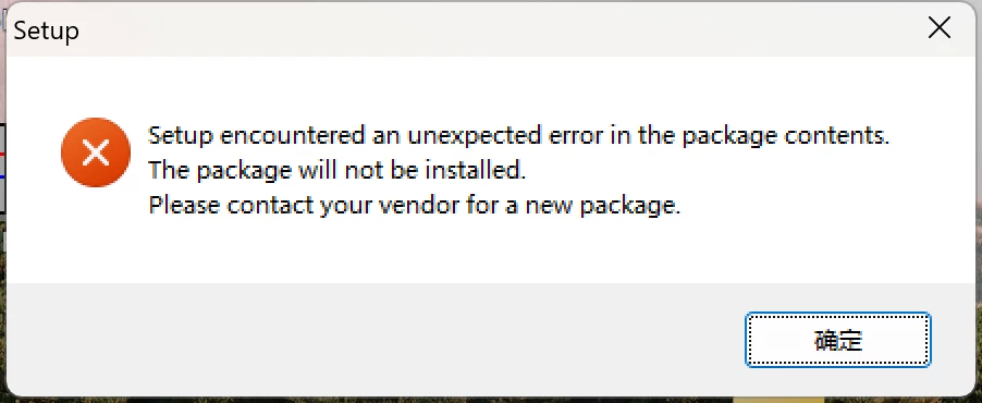

我换了一根USB-TYPEC连接到STEVALUSBI2C,成功修复了,但仍然无法连接到GUI,我看到其他帖子要下载VCRedist 10.0.40219.325,,我找了安装包,但是提示我安装出错
Translation:
I changed a USB-TYPEC to connect to STEVALUSBI2C, and it fixed it successfully, but I still can't connect to the GUI. I saw other posts to download VCRedist 10.0.40219.325, and I found the installation package, but it prompted me that the installation was wrong.
