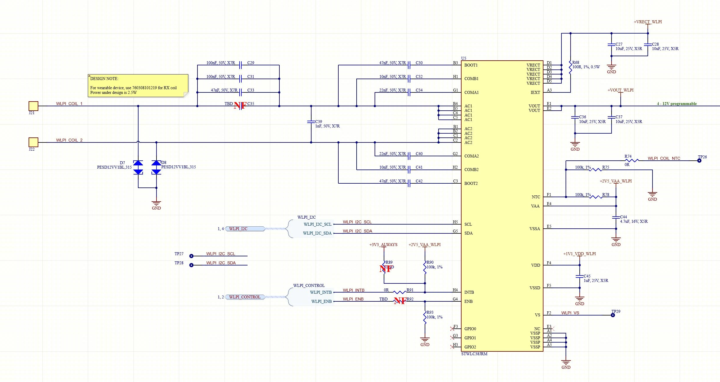

I am designing the custom wireless charging receiver using the STWLC38JRM chip
Currently, when I put the circuit on the wireless charging pad (Qi standard), I notice that the STWLC38JRM chip does not output 5V at the VOUT pin.
Below is the schematic, I copied all the things from the STDES-WLC38WA board, the coil part number is 760308101219 but the circuit does not work, the only thing that worked is the I2C communication, when I supply 5V to the VOUT pin, I was able to communicate and read ID chip.

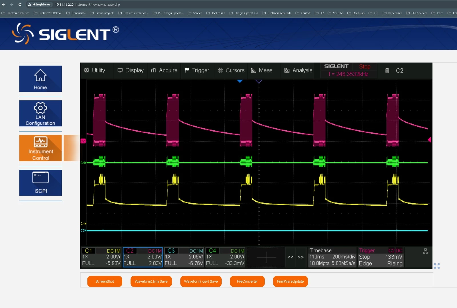

and Below the schematic is the scope that I captured when put the circuit on the wireless charger pad
Red is AC1, green is AC2, yellow is VRECT, and blue is VOUT
I see the VOUT is still 0V and the AC1, AC2, and VRECT waveforms look like wrong.
Currently, I don't use the temperature sensor NTC so I designed a 100k resistor pull-down and 100k pull-up to VAA at NTC (F1 pin).
Can you guys help me fix this issue?

seems you follow our STDES-WLC38WA design. Please follow below link:
coil 760308101219 is 11.8 uh, based on https://www.we-online.com/components/products/datasheet/760308101219.pdf.
From your sch C tank is 247nF, seem right
From your waveform, Vrect send some ASK packet and then drop power, seems TX CEP timeout.

I copied all the schematics of the STDES-WLC38WA design, but my circuit does not work.
I think the schematic is correct.

With the above waveforms, what should I do next?

STDES-WLC38WA design work with STDES-WBC86WTX, and coils is smaller.
But you use TX with standard coils,
I suggest you modify COMA/COMB Cap value, make it larger, currently your sch COMA Cap 22nF and COMB Cap 10nF, suggest to modify to COMA Cap 47nF and COMB Cap 22nF
