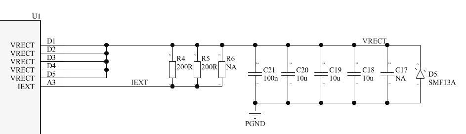

Hello experts,
I have a question about how to determine the resistance value.
In STEVAL-WLC38RX circuit schematic, R4 = 200, R5 = 200, R6 = NA.
What is the idea behind the values you set?
The electrical characteristics in the datasheet for STWLC38 state Imax = 0.3[A](*1) when Vrect = 5 to 10[V].
   (*1)Non-repetitive 100 ms rectangular pulse
Are the resistance values based on these ratings?
Or is it set based on an experiment?
For now, I plan to use two of the same resistors as on the evaluation board.
Note that only the BPP will be implemented.
Regards,
Ryoma

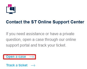

I would like to know if it is safe to charge in BPP using the same parts as the evaluation board.
From now on, I will ask questions at “Support Home.”
Should I click on the link in the red frame in the figure below to make an inquiry?
Regards,
Ryoma

Didier HERROUIN
Jul 11, 2025 1:19 PM UTC
These resistors are part of the Over-Voltage Protections.
Indeed, when the VRECT voltage exceeds the programmed threshold (VOUT + SOVP THRES), the resistors are grounded through internal switch to protect the circuit.
For your next requests, do not hesitate to open a case on st.com (https://www.st.com/content/st_com/en/support/support-home.html#), I will be able to support you directly.

Didier HERROUIN
Jul 23, 2025 7:58 AM UTC
Exactly !
Then, you will reach the Online Support website where you can create a new case.
Depending on your region and the product, it will be redirected to the right person in ST.
