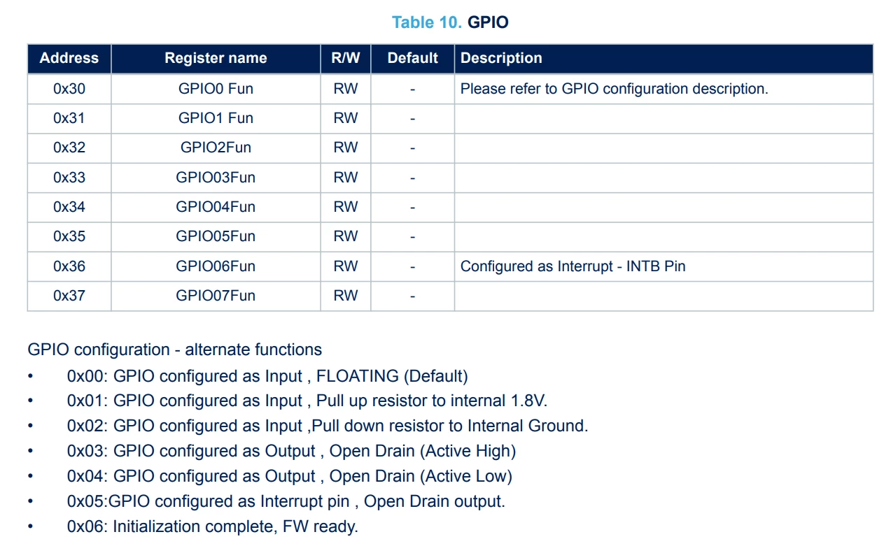

I'd like to use GPIO00 ... GPIO04 as outputs to select the used coil from a coil array for power transmitting.
I've seen the i2c addresses of the GPIO's configuration at 0x30 and followed. I'm wondering what address is foreseen to read or write the GPIO data. Have I overseen anythink?

See Table 10 in the datasheet for how to configure these pins. Note that they are open drain.

Hi TDK, thanks, the question was not about the configuration but how the GPIO data should be read or written ...
Is there a register to read/write this bits itself?

To configure the pin as open drain low (i.e. outputting a low signal), set it to 0x04. To configure it as open drain high (i.e. high impedance), set it to 0x03. Is this not what you're seeing?
As an open drain output pin, these are the only two states it can be in. No other GPIO data register is necessary.

I understand you want to control gpio high or low,
for example control INTB/GPIO6 high/low set as below
or use I2C reg command W 0x0036 0x04 set high
or use I2C reg command W 0x0036 0x03 set low.
Also you can use other GPIO, Test waveform

Hi willzhou, from my point of view this is an unusual approach to set a data bit, however how do i read in a bit after i have set it as floating?
Feb 21, 2024 9:52 AM UTC
Hi Andreas
Yes, it is unusual approach , not like STM32 MCU we do not open GPIO register to customer.
So we use this way to control GPIO.
Question: however how do i read in a bit after i have set it as floating?
Answer: you need to read 0x2001A01C address, we connect 1.8V to GPIO1 and nothing to GPIO0.
use gui and read this value data is 0x02, bit1 is 1 means GPIO1 is high.
