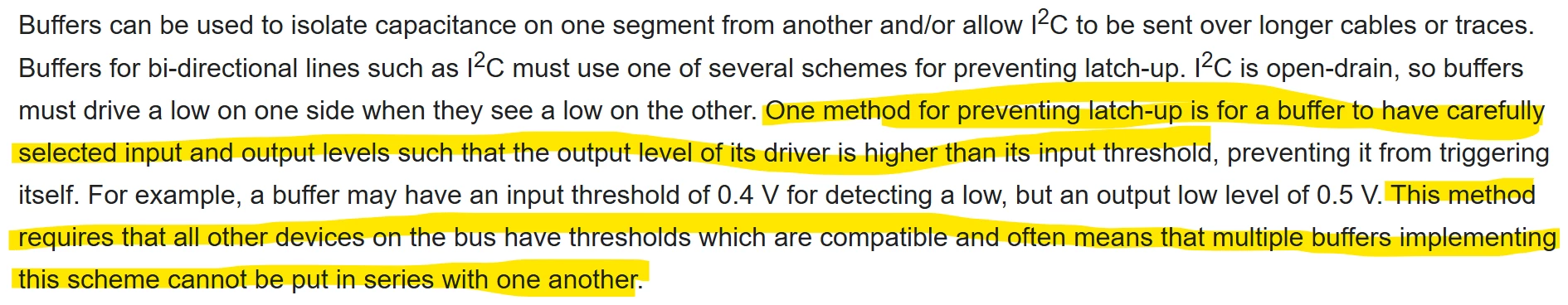

the maximum I2C input low voltage is stated as 0,35V for the STUSB4761.
Is this a typo?
Because in NXP I2C spec this level is stated as 0,3VDD
We are using a PCA9516 I2C Multiplexer (0,5V Low) and observe massive connection failures with STUSB4761.

Nothing would indicate it's a typo. 0.35 V is less than 0.3*VDD so is compatible with the NXP I2C spec.
Likely will need to debug this further. Look at the SDA/SCL signals on the line to see if they are valid or not. Ensure you have appropriate external pullups present.
That is the problem.
I2C Spec allows up to 1.5V for a valid Low_In (0.3*Vdd @ 5V )
STUSB fails if I2C low level is above 0.4V. (No ACK)
Furthermore it will detect a logical high above 1.2V.
1.2V is less than 1.5V.
Please explain how this could be compatible to NXP I2C spec.
I replaced the PCA9515 against a Nfet Switch / Level Shifter on SDA and the failure is gone.
You're right, I misread.
To the original question, it's unlikely to be a typo, especially as you've confirmed the issue. It appears this is done to prevent latch-up.

Hello
Correct, please refer to table 16 for level triggering which need to be use. There is no typo .
