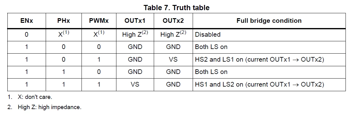

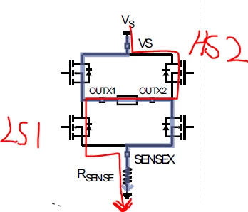

0693W000005AjXFQA0.pngFor PH 0 & PWM 1, is the current OUT1 -> OUT2 correct?
I think the picture below is an act for the above case.0693W000005AjXeQAK.png
If my guess is wrong, how do I rotate the motor in the reverse direction?

Hi @Minkyu Kim​  and welcome to the ST community !
Thanks for your remark, you are correct: there is a typo on the datasheet.
When PH = 0 and PWM = 1, the current flows from OUT2 -> OUT1.
The typo will be fixed in the next datasheet release.
Have a good day !

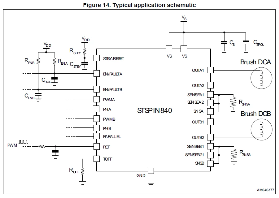

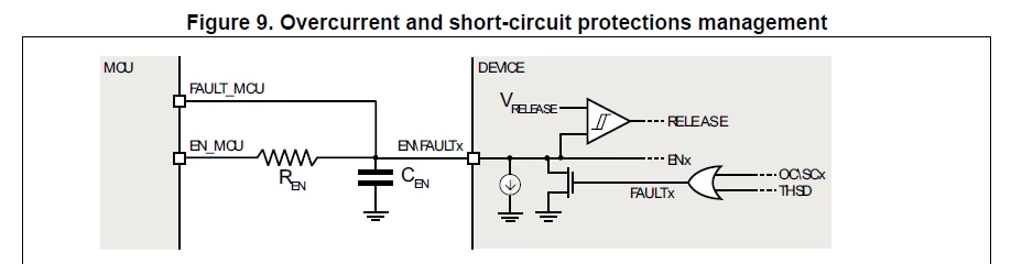

0693W000005ArkRQAS.pngPage 19 in datasheet, R_EN and C_EN's value are 39KΩ and 10nF.
In the graph that is the basis of the recommended value, the value of V is 3.3V.
0693W000005ArkMQAS.pngAlso in page 18, FAULT and EN pins in MUC are tied Driver's EN/FAULT pin.
0693W000005ArkbQAC.pngAnd this typical schematic, each EN/FAULT pin's resistor is tied V_DD.
Do they have to be tied to 3.3V or is it okay to configure as shown in Figure 9?(In this case, VDD means the MCU's EN pin is 3.3V?)
A lot is difficult because it is the first time to design.
Thanks for your help.
