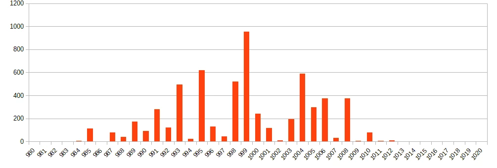

I set up a test of just reading the potmeter coupled in on ADC channel 4 on the board using different sample&hold times. What I discover is discrete errors.
With 1000 readings at 10ms intervall of potmeter adjusted to approximately give 1000 in raw value from ADC I received data containing only the values 975, 979, 983, 987, 991, 995, 999 using 13.5 cycles capture&hold.
Looking at these in binary I see:
975 = 00000011 11001111
979 = 00000011 11010011
983 = 00000011 11010111
987 = 00000011 11011011
991 = 00000011 11011111
995 = 00000011 11100011
999 = 00000011 11100111
Lower 2 bits seem stuck at 1 and the total noise is far too high.
Measuring externally I see approximately 832mV on the input.
Keep in mind there is a 4.7nF capacitor to help buffer the signal being drawn in by the 8pF internal ADC capacitance. This should be ok for a somewhat close reading.
I cannot find any errata for the STSPIN32F0A so I am unsure if this is known or discussed.

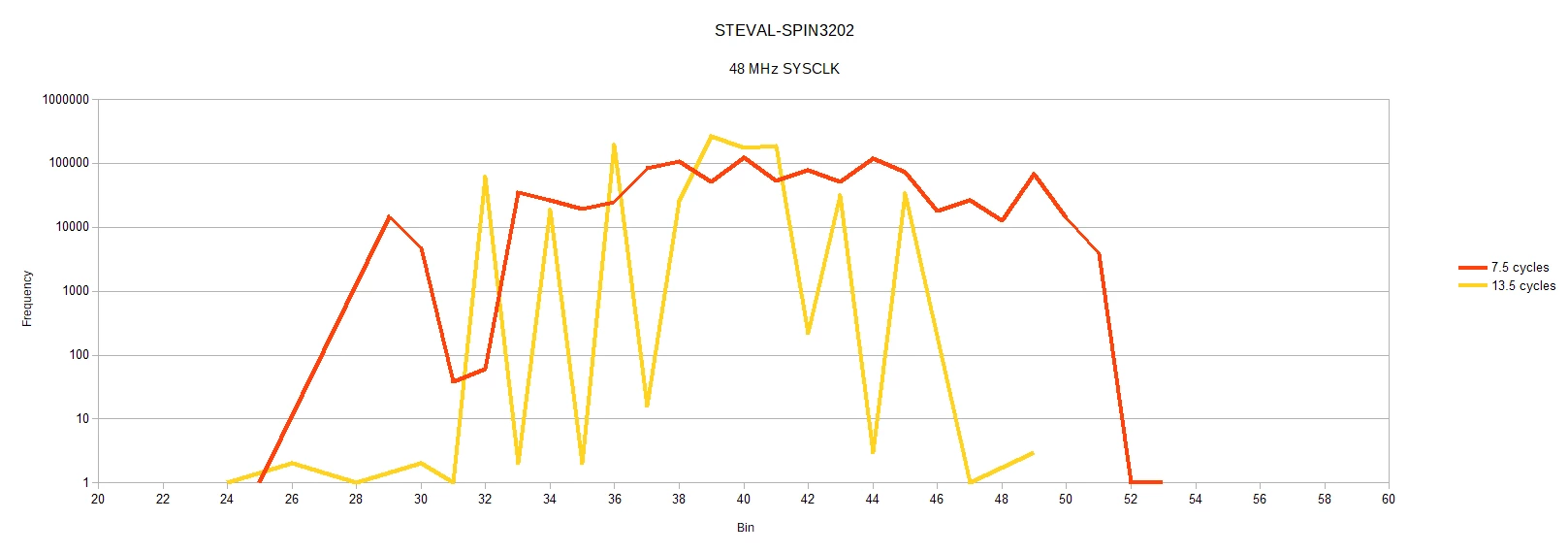

Jan 21, 2021 2:58 PM UTC
Using maximum sampling time results in some data in the blank areas.
0693W000007CC0FQAW.pngIt is clear the spread is very large due to some source of noise in the eval board but the distribution is still puzzling.

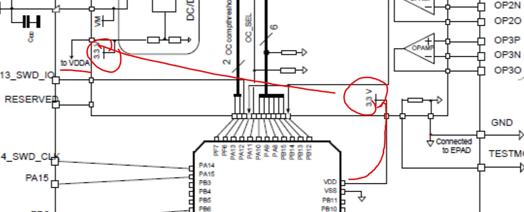

Jan 24, 2021 10:12 PM UTC
I think I narrowed it down to an internal connection in STSPIN32F0A that, due to internal connections again in the 3x halfbridge control causes VDD to be tied in with VDDA. This seems to create a lot of noise for the ADC.0693W000007CSIZQA4.png

kyrreaa
kyrreaaAuthor
Jan 25, 2021 9:16 PM UTC
Seems like the entire problem is the bond for the boosters ref to VDDA. Since it shares 3.3v internally in the driver chip it should not be on VDDA. I guess bonding issues forced this?

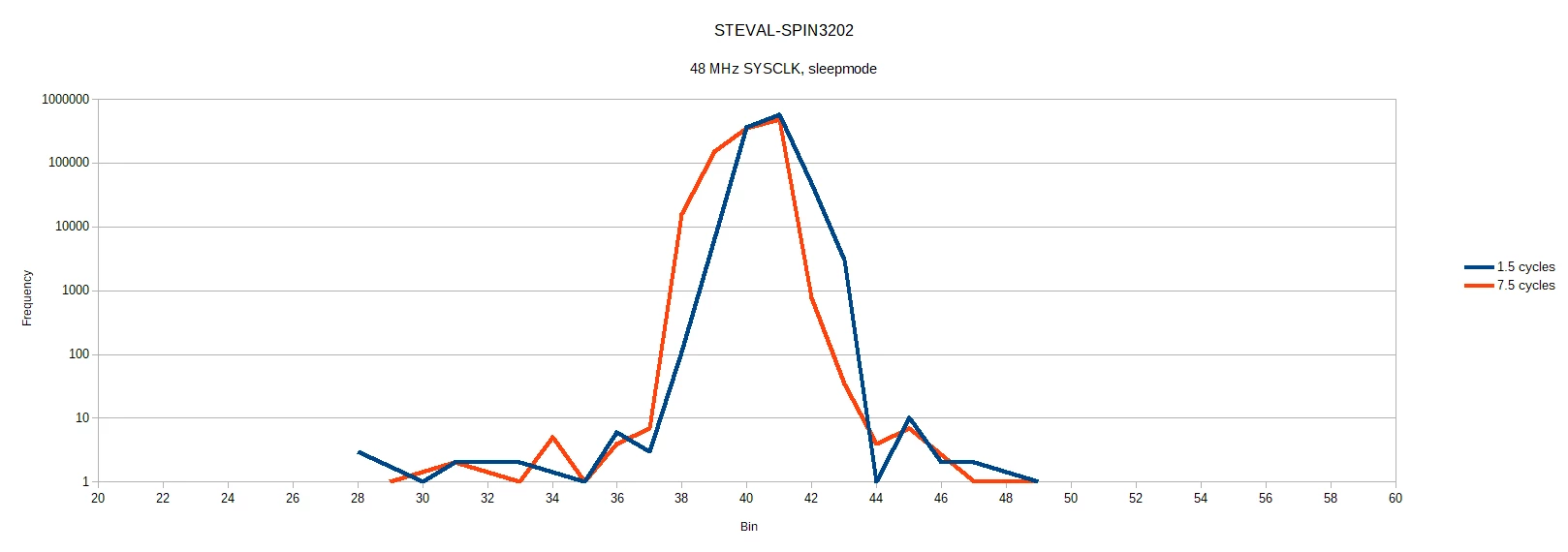

Doing a test the chip runs even with just VDDA so VDD is getting power when using external ldo...
So, I put together a test using sleepmode to see if the MCU noise is what is leaking over to VDDA. It absolutely is.
Sampling is again AD3 from Speed pot, and to make it statistically significant it runs 1000000 conversions and counts all the resulting values in 1 bit wide bins before sending final result table over USART1.
