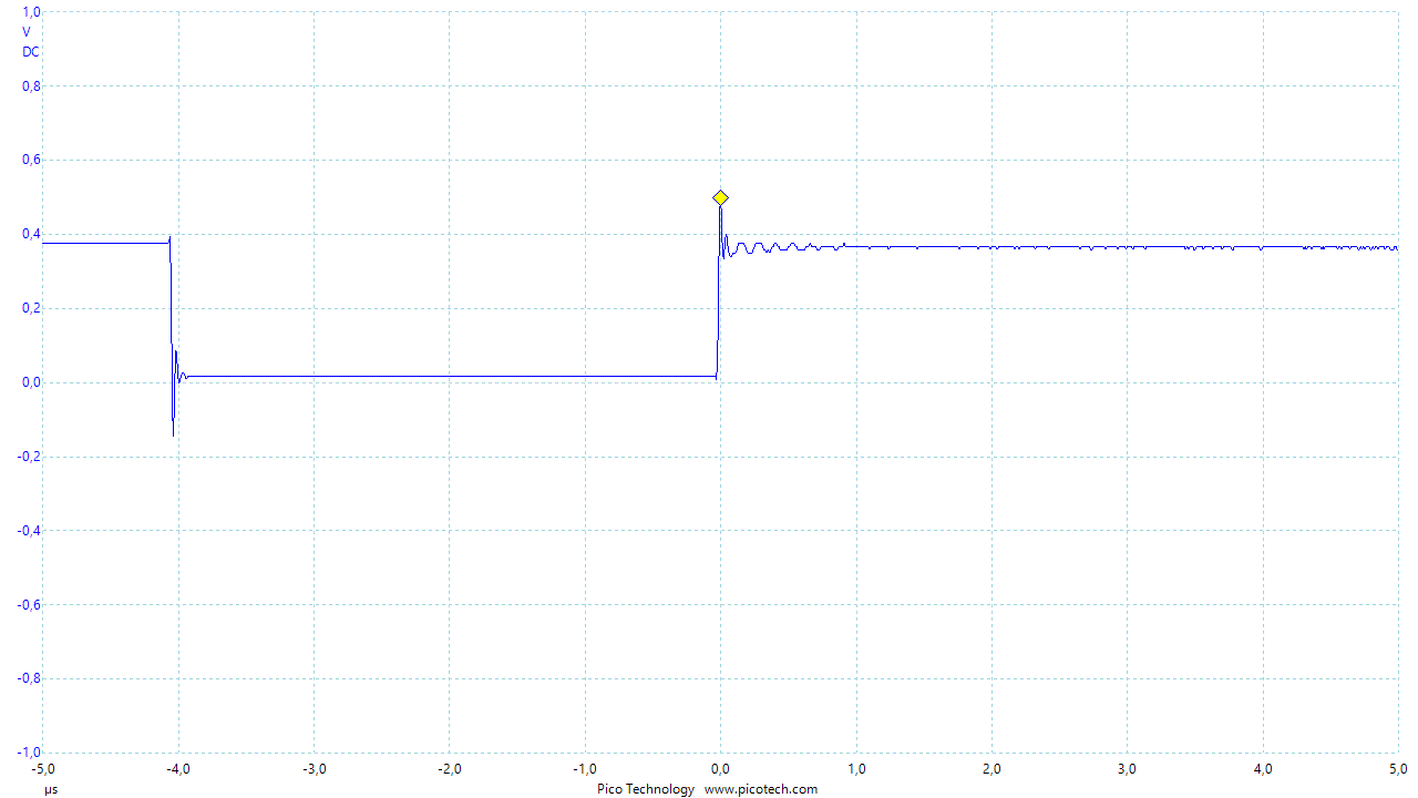

But I have another issue. When I connect a 3VDC motor to it, it also triggers the fault when the DC motor is starting under a load. Perhaps it could be the overcurrent due to a small amount of stall condition? But if I measure the sense resistor of the X-NUCLEO-IHM13A1 evaluation board, I am not measuring an overcurrent. See below the voltage what I measure.
What could be the reason that it triggers the fault in this case?

The blue line is the FAULT led (which triggers when pulled low). The yellow line is the sense resistor. As you can see there is a current of about 1,47A (500mv/0,34ohm). But then suddenly the voltage drops to -500mv (so -1.47A) and then shortly after it the FAULT is triggered. Does this happen because of the sudden voltage drop to negative? Because 1.17A should not be enough to trigger the overvoltage.
The strange thing is, this happens only between 3V-4V with a 3V nominal DC motor. When I load a 7.4V nominal DC motor with the same power I have no problem with this. Because the current is half it's not triggering anything. But I just need to know what exactly is causing this, because like I said with a 3V motor I can't get the full power out if it (which is 2.1A at full load) because the STSPIN250 triggers a fault.

​Hi @GHoll.1​,
try to investigate the root cause of sense voltage inversion to understand if it can be related to FAULT trigger.
There are two hypothesis that can cause the sense voltage inversion:
  1. PH signal change (the opposite diagonal is switched on)
  2. STBY/REST signal low (the device enters in the standby status and the outputs are in high impedance, the current flows through the freewheeling diodes)
Could you make some oscilloscope screenshot monitoring the PH and STBY/RESET pin signal triggering on the sense voltage inversion?
In this way we can verify if some noise causes the status change of one of this two pins.

Jul 23, 2020 4:31 PM UTC
Hi @Cristiana SCARAMEL​ ,
I did measurements on the PH and STBY/REST pins, but there is no change on those channels.
The voltage inversion what you can see in the oscilloscope screenshot, is the back EMF because of the sudden stop of the motor.
So for me it's still unknown why this is happening, because I can't measure any overcurrent whatsoever, and like I said before this only happens when I use it between 3-4V. When I use a 7V motor it operates normal.

Hi @GHoll.1​,
to better understand what is happening, could you give me more details?
Are you using internal PWM current control or provide the PWM input directly?
The voltage inversion on the sense resistor is consistent with the transition from diagonal on and current recirculation in fast decay.
With this device the fast decay (on freewheeling diodes) is possible only when the device is in high impedance: EN set low by external or internally pulled low after a failure.
More oscilloscope screenshot should be useful showing VS voltage and OUT voltages.
