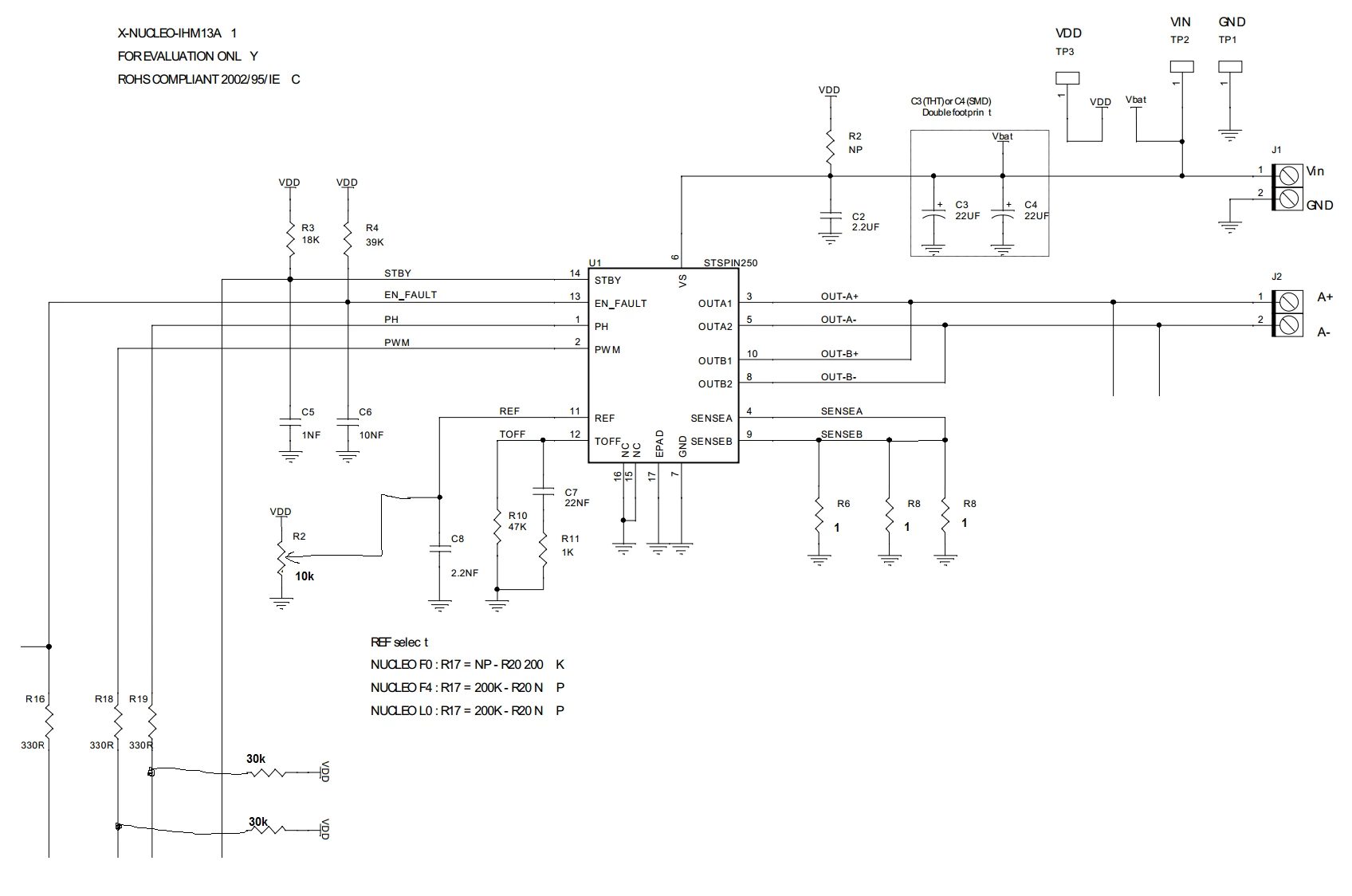

STSPIN250 EN/FAULT pin problem
good afternoon!
I can’t read the FAULT state when the specified load limit is exceeded. the oscilloscope shows that the signal does not drop to a logical zero.

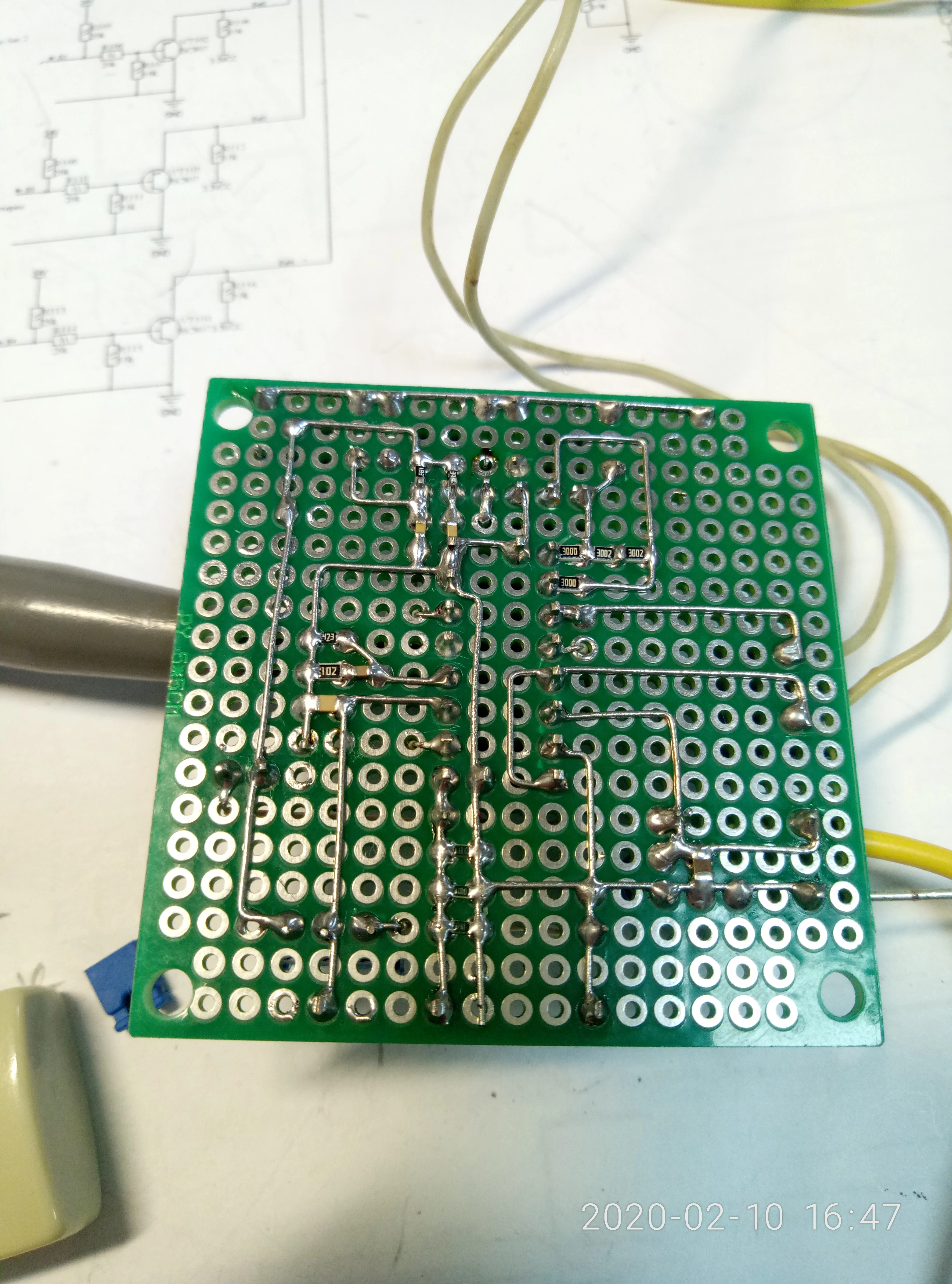

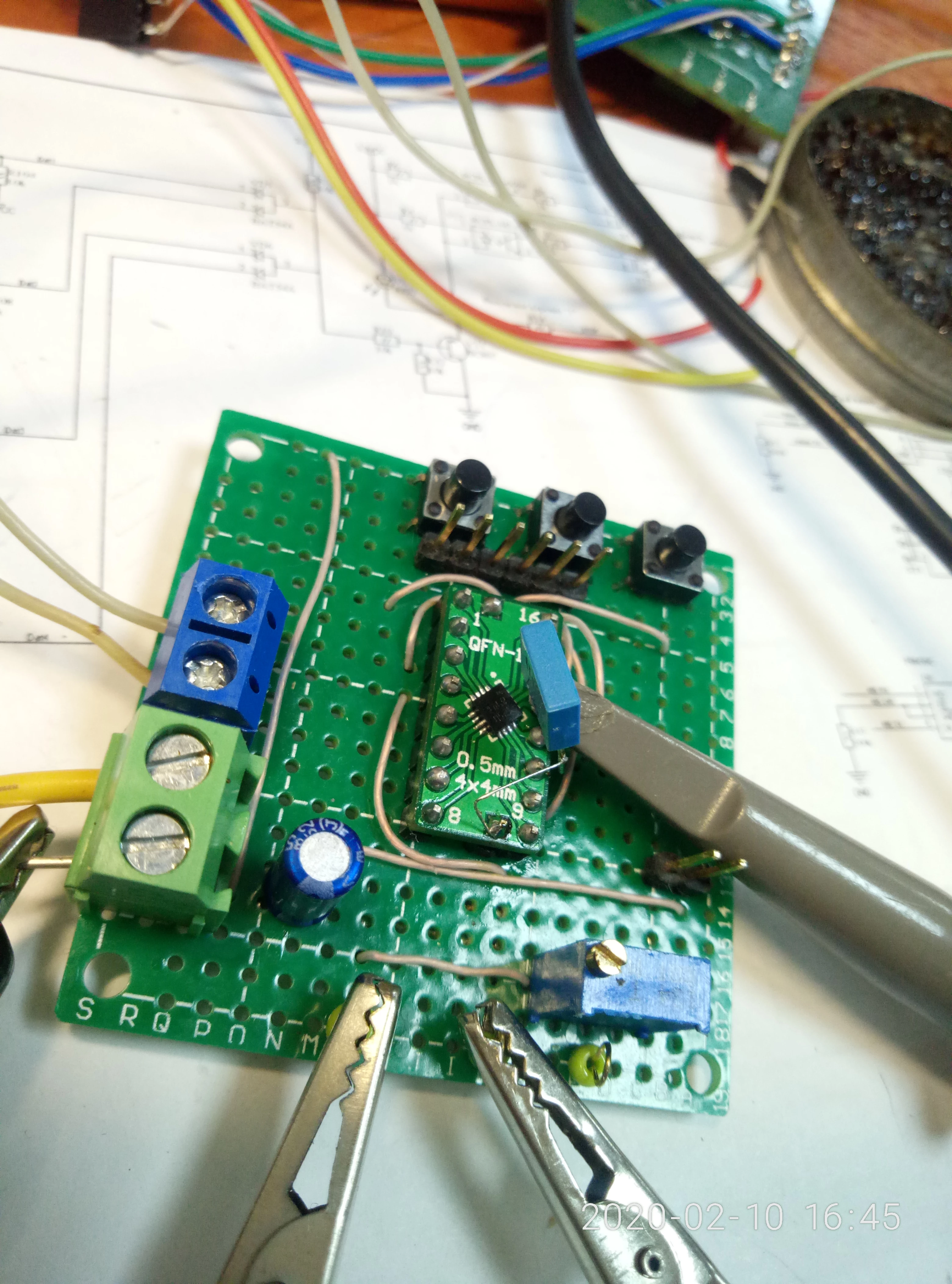

my board

​The current "limit" set through VREF and SENSE signal is used for PWM current control.
When this peak current is reached a current decay sequence is performed (refer to paragraph 6.3 of STSPIN250 datasheet) and no FAULT signal is generated.
The FAULT pin is forced low when the overcurrent or the short-circuit protection is triggered (see paragraph 6.4).
If you do not use the PWM current control, you should make sure that the maximum sense voltage (Rsense x Iload,max) is always lower than set VREF voltage.

​Hello,
what is the value of pull up resistor connected on EN/FAULT pin?
Moreover, for a better support please share the board schematic.

set different values
R4 - 18k, 36k, 100k
C6 - 10nF, 47nF, 2.2uF

​Please, give more details on the application:
  • VS supply voltage value
  • Load type
  • VREF voltage
Moreover, what do you mean with "specified load limit"?
If you refer to PWM current control and the load current target value, in this case the EN/FAULT open drain pin is not activated.
If instead you are referring to overcurrent protection, keep in mind that the typical value is 4 A.
Could you provide some oscilloscope waveforms when the overcurrent occurs showing:
  • the load current
  • sense voltage
  • EN/FAULT voltage
Regards, Cristiana

I do not use PWM.
that is, you want to say that when the current limit is triggered (using WREF and SENSE signals), a FAULT error is not generated?
