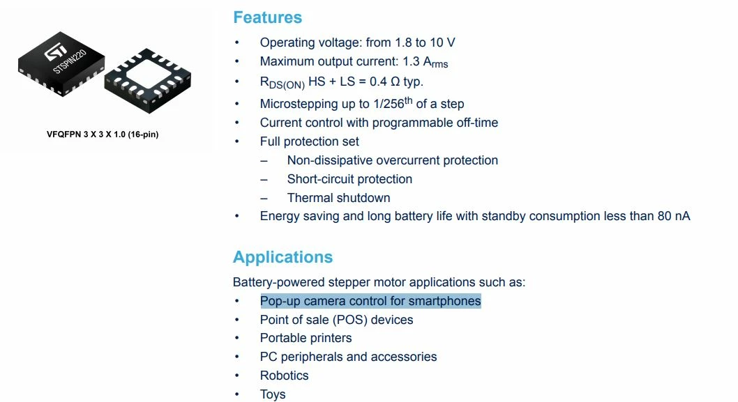

I see that STSPIN220 can be used for "Pop-up camera control for smartphones" application.
Can you tell me other IC with the same application?
Which smartphone brands used them? I am sorry for this inconvenience.

No, I can't give you other ICs for this use.
You'd like to know which smartphone brands use them? Well, it doesn't look like a technical question, does it?
