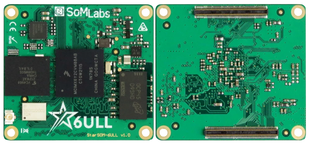

This board appears to be close to the listed features:
StarSOM-6ULL-intro
The StarSOM-6ULL (SLS06) family is a SoM based on the NXP i.MX6 ULL application processor. The StarSOM-6ULL features an advanced implementation of a single ARM Cortex-A7 core (at speed up to 900MHz).
The StarSOM-6ULL (SLS06) is a low power highly integrated SoM featuring high computation power, 802.11b/g/n Wi-Fi and Bluetooth v5.1 connectivity and on-board Ethernet 10/100 PHY interface. The option of integrated, fully certified 2.4GHz Wi-Fi and Bluetooth BLE 5.1 module simplifies the carrier board. Module provides a variety memory configuration including DDR3L and eMMC memory.
The SoM supports connections to a variety of interfaces: two high-speed USB on-the-go with PHY, dual Ethernet, audio, display with touch panel and serial interfaces. In addition, the system supports industrial grade embedded applications.
Square shaped PCB of StarSOM-6ULL module is equipped with board-to-board, low profile connectors with 2×100 pins.
For evaluation purposes we offer dedicated carrier board StarCB-6ULL.
https://somlabs.com/product/starsom-6ull-sls06/
