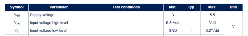

Can You show your schematic. If the MCU is powerd by 3.3V and the STP16CPC26 by 5V you are violating the min. Vin voltage (0.8*5V = 4V against 3.3V from the MCU)
DSudo.2
DSudo.2Author
Jun 21, 2025 5:16 PM UTC
Oh my goodness... what a rookie mistake! Thanks so much for solving that problem... it was driving me crazy. Sounds like our design review process needs one more thing added to the checklist.
