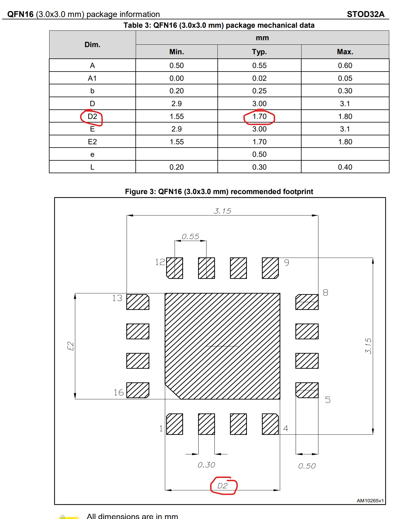

Actually, D2 and E2 should simply be not referenced on the drawing.
0.55 should be 0.5, per `e` dimension.
So now 3x0.5+0.3=1.8mm
It should be numerically written 1.80 and then everything starts to make sense.

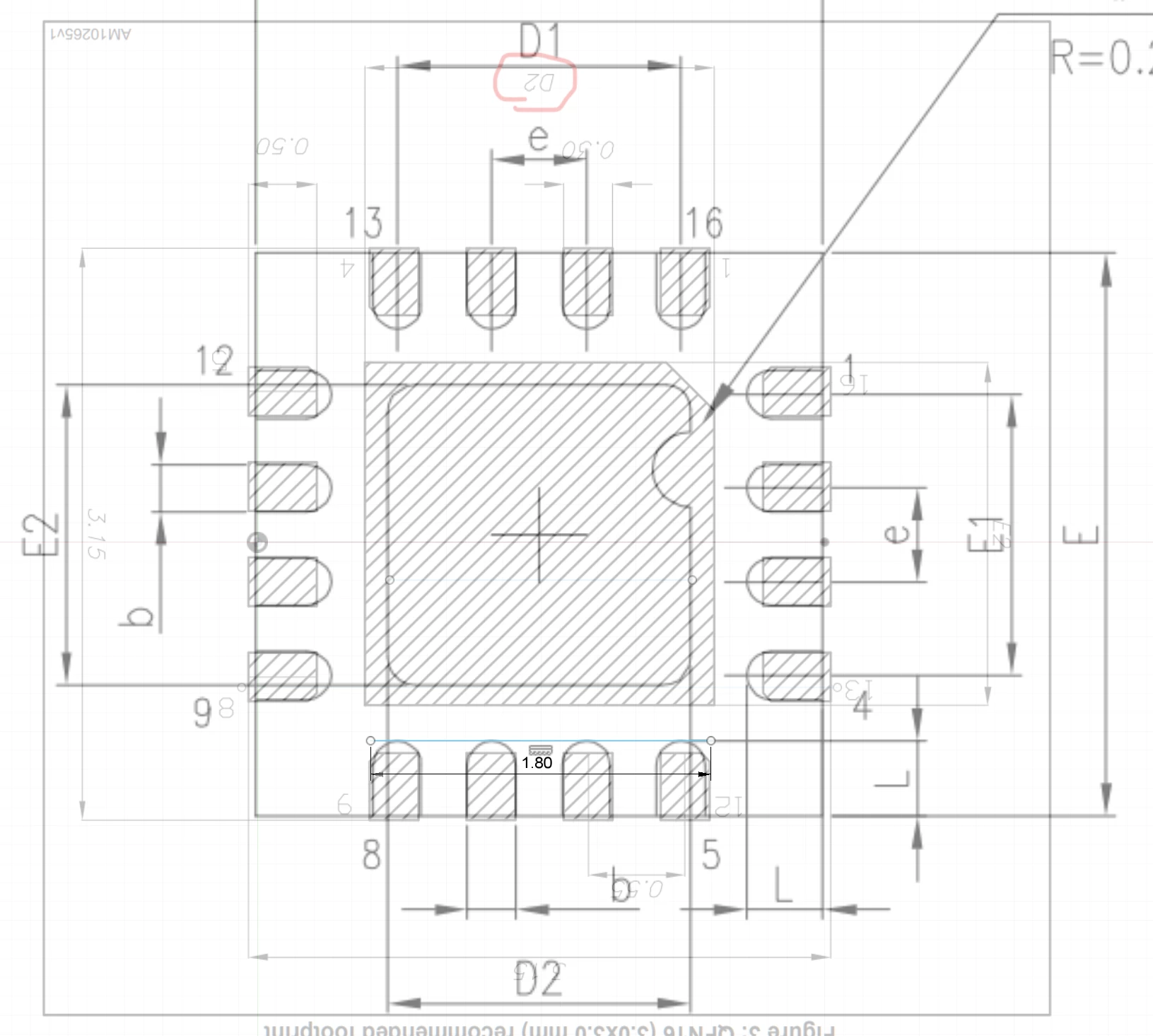

Here is an overlay:

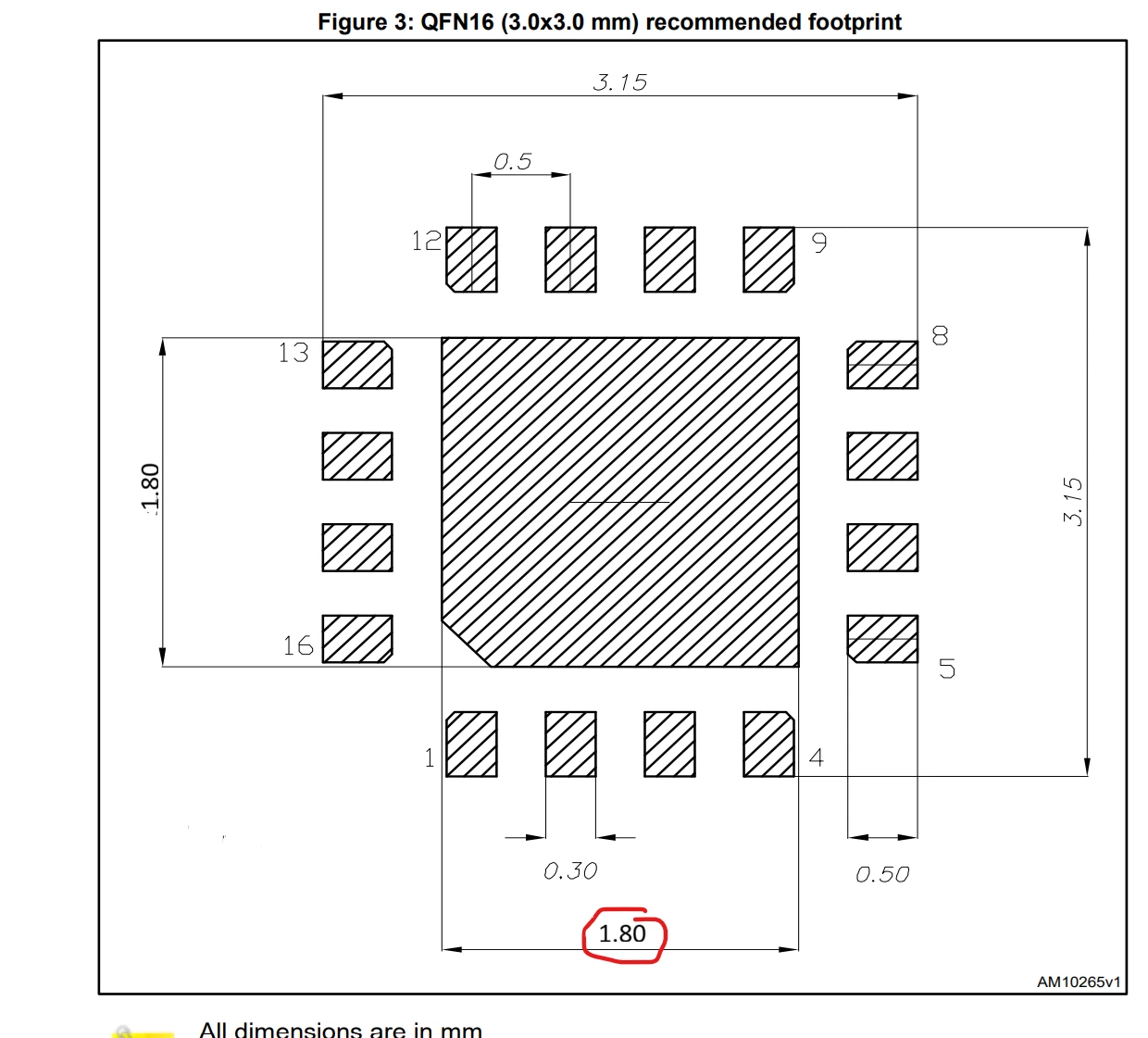

And here is corrected drawing:
