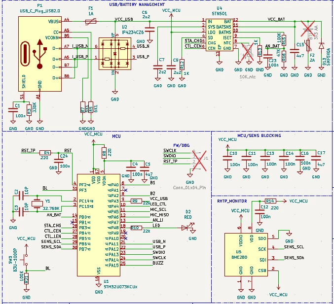

The schematic-power supply part is here: LDO is supplying just low power chips(mcu and sensors). DNP components are soldered manually so they are present.
The schematic suply/mcu/sensor part is here:
From your datasheet it looks like the internal battery switching mosfets(M3,M4) dont turn on the battery or are damaged(no SYS voltage).
LDO capacitor: In your datasheet there is stated 1uf in the table 3., Application schematic  above in the same datasheet (table2)recomends 2.2uf cap. Ive added higher value(C17)as well. Might it be causing this problem? There is no range of caps where your LDO is stable writen in the datasheet. However, it looks like its happening before LDO...

It does indeed appear that the anti-series connected MOSFETs M3 and M4 are damaged, which could have several causes, e.g. ESD pulses, as MOSFETs are very sensitive to overvoltage. It is conceivable, for example, that such ESD events occurred when connecting or disconnecting the battery. To avoid such events, it is advisable to connect a TVS to IN, SYS and BAT/BATSNS against GND, which you have already done with U2 and D13. However, if we do not know the possible ESD events and their energy levels, we cannot say whether the peak pulse power of the IP4234CZ6 (100W) and the SMF5V0A (200W) is sufficient to protect the STNS01 from those pulses. You must not ignore the differential resistance of the TVS, which can cause voltages to occur in smaller TVS such as these that exceed the maximum rating of the STNS01 (VIN: 10V, SYS: 6.5V, BAT: 5.5V), meaning that the STNS01 must be considered irreparably damaged. Instead of the SMF5V0A, you could take a look at the SMA6J5.0A, for example, which has comparable voltage values but can provide significantly better protection with 600W, which is why it has (must have) a slightly larger package.
As far as the LDO capacitor is concerned, the relevant specifications are purely recommendations and should be understood as minimum requirements. Whether 1µF, 2.2µF or 4.7µF are connected to the LDO pin is secondary and should not be considered the cause of the observed failure. The important thing here is that you use ceramic capacitors.

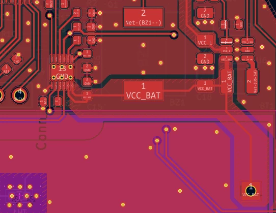

On the bottom picture is STNS01 part PCB layout if needed. Battery is on the bottom. PCB is 4Layered, middle
layers are continuous GND layers.

2.)My device should have different behavior when suppled from usb and different when supplied on battery. Now I was able to test them. Unfortunately It still worked as USB supplied. I was able to measure 2V on unconnected usb power line(VCC USB on schematic). I added pulldown resistor 10kOhm but it wont helped. So I set up multimeter to mA reading and shorted unconnected USB supply rail with it. Measured current was 1.68mA-that is a quite big leakage.
3. @Peter BENSCH in the end I can say you were right with ESD, however damaged is M1 and discharge came via weaker USB protection and usb cable. M3&M4 disconnect is probably a consequence. For this project I have some space so Ill use aditional esd diode on USB voltage rail. However second project is pen sized and there is no place for such a big protection.  Im considering to replace the polyswitch fuse with some high impedance and lossy ferrite bead which should reduce peak current and ESD protection voltage drop .
