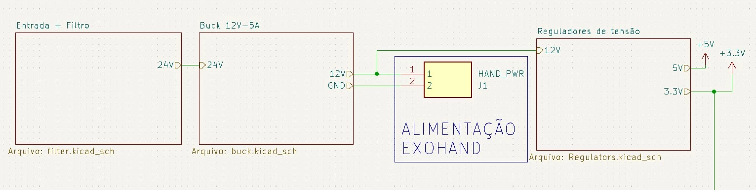

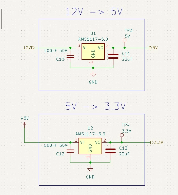

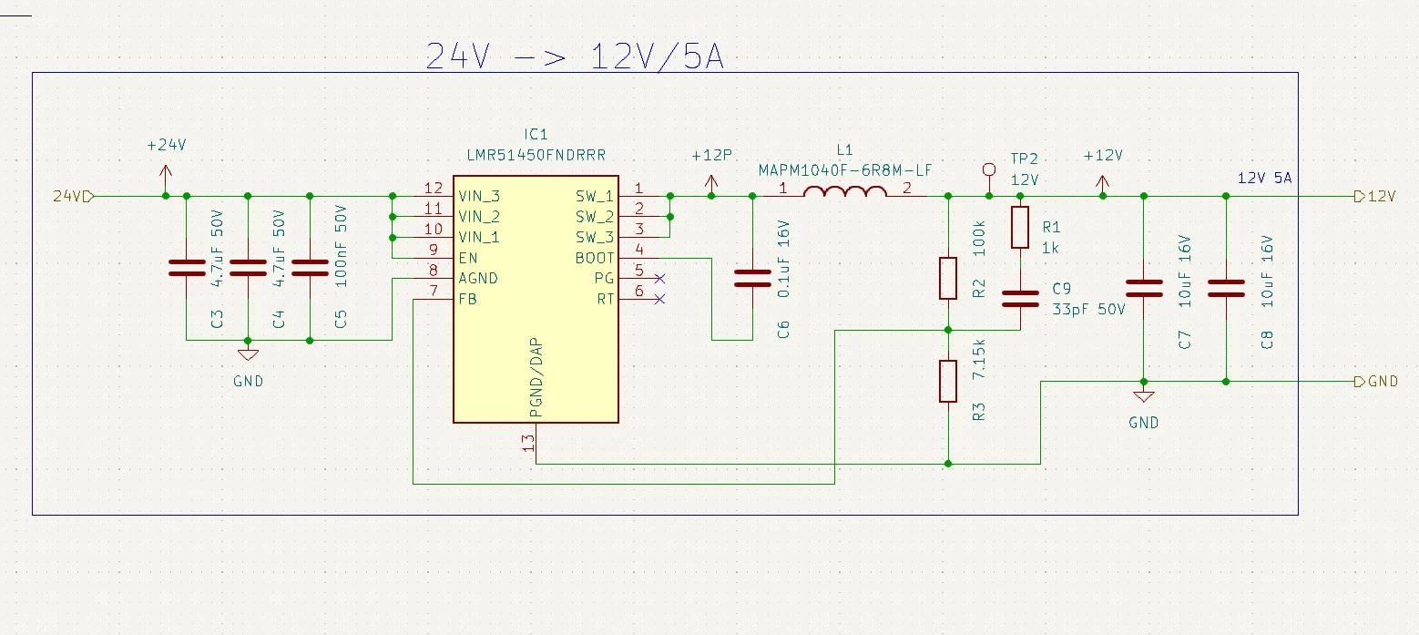

AgattiAuthor
Feb 15, 2024 3:26 PM UTC
This is pretty much the power supply for the PCB. It has a filtering stage, a buck 12V/5A for another motor (has a completely different PCB project from the 24V one, consumes up to 5A) and the LDO regulators stage. The board itself is powered by 24V from a medical power supply device (127Vca / 24Vcc).
Both 24V and 12V are sent directly to theirs respective PCBs. Should I use any method to grantee some level of protection against peak voltage fluctuations?
