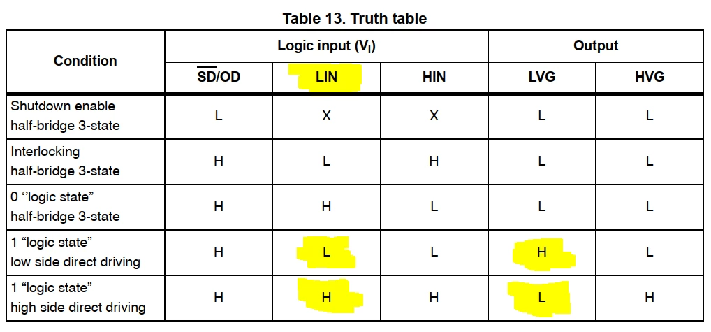

Hi, i'm using a STGIPL20K60 IPM (SDIP-38L) .
I have a two questions :
  • Regarding the control signals :
on ST website produt page regarding which states "Logical Function" : "Negative Input" ; this information is not stated in product's datasheet and not clear enough ?
And in the datasheet gate signals input (HIN and LIN = "NOT LIN") are mentioned, does this mean that wanted LIN signal have to be inverted ?
The truth table states quite the opposite and is contradictory with the waveforms (page 14). (maybe a typo?)0690X0000089HkuQAE.png

Yes it should say /LIN in the table
