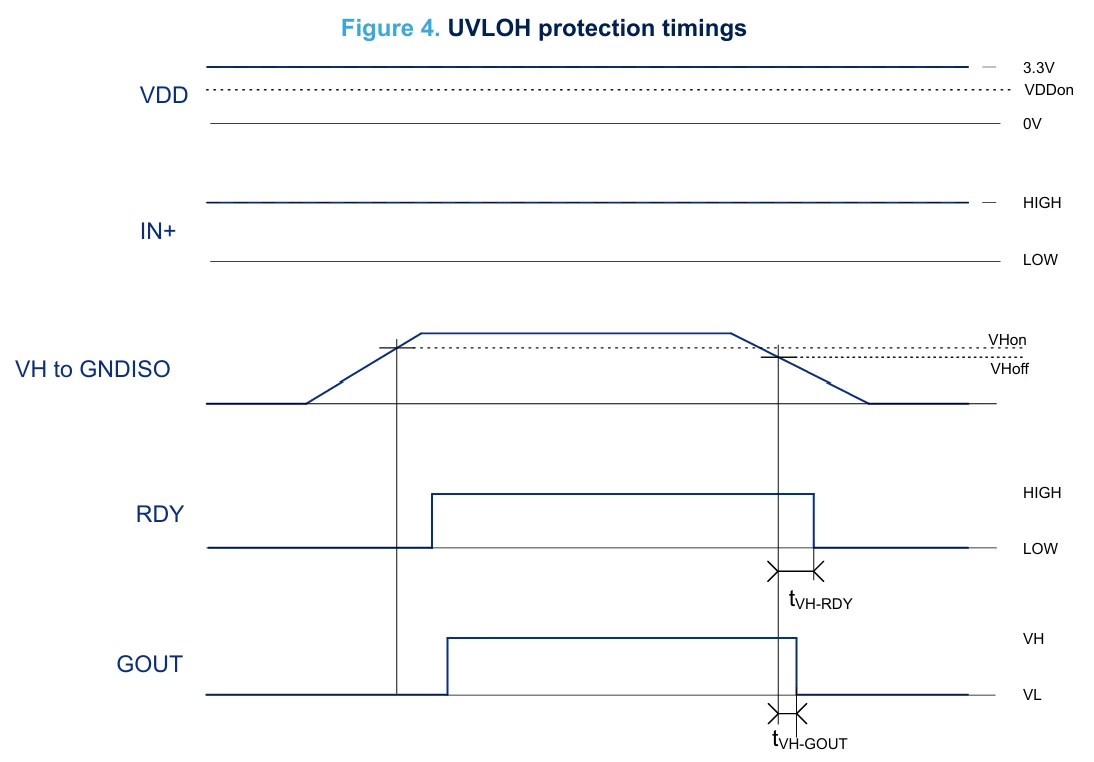

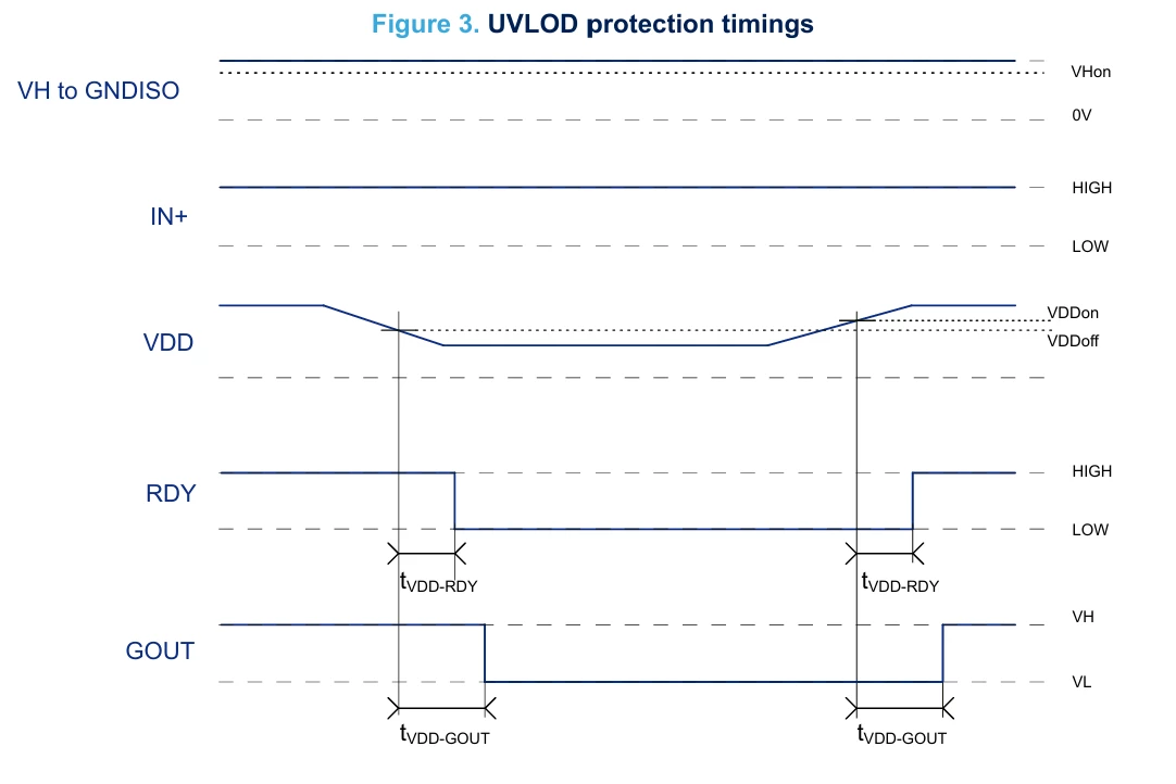

For READY with UVLO protection, two kind for waveform may need to check accroding to the datasheet. One is VDD which already checked with no problem accroding to your feedback. Another seems with VH supply pin. There are about 3.5us delay about tVDD-RDY and 20us delay about tVH-RDY. Please refer to EVLSTGAP3SXI Data brief Half-bridge evaluation board for STGAP3SXI IGBT galvanically isolated gate driver with protection for schematics as well as datasheet for layout recommendation
