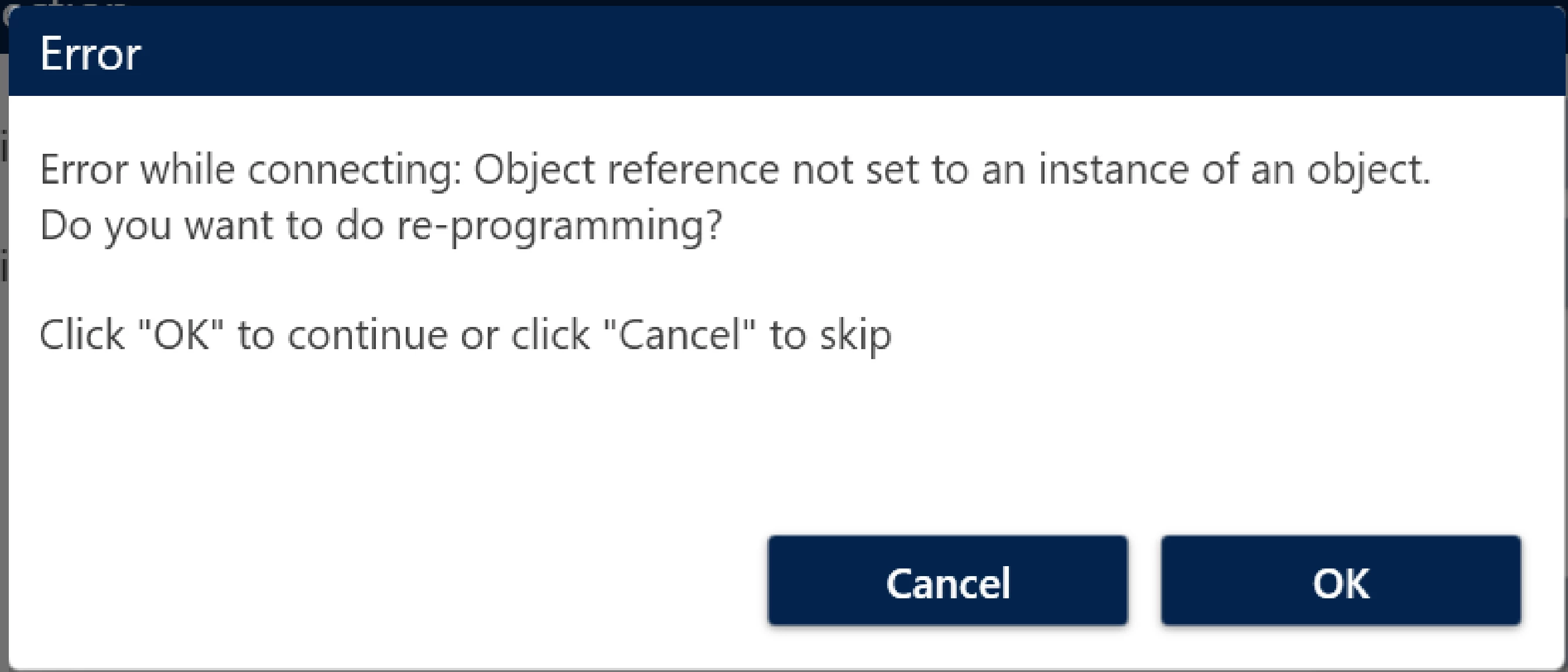

I get an error message when I try to connect with the STEVAL-WLC38RX evaluation board using STSW-WPSTUDIO.  I am using v2.7.2 of WP Studio.  See error message attached.
willzhouBest answer
Nov 17, 2024 2:39 AM UTC
also suggest you try other version of GUI
GitHub - STwirelesscharger/STSW-WPSTUDIO: ST wireless charge chip tool
OR you can use console way to download fw.
https://github.com/STwirelesscharger/STSW-WPSTUDIO/blob/main/a1_wlc38_downfw.bat

I'm including the error message here for convenience. It seems like it is connecting but throwing an error.
Nov 17, 2024 2:35 AM UTC
It show you have some error with firmware in rx chips, if you click OK it will go to re-program.
