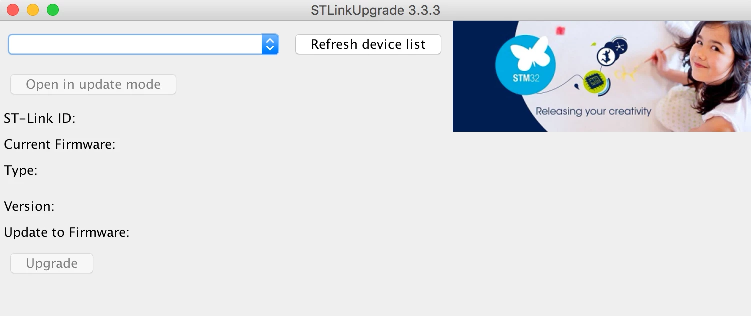

I have a STEVAL-STSPIN3202 evaluation board and trying to setup the environment on MacOS. When I plug in the eval board with a USB B cable to my MacBook, I don’t see a device in both ls /dev/tty* and ls /dev/cu*
No devices even when I do, ioreg -p IOUSB
PortableA2-2:AllPlatforms jaimeyu$ ioreg -p IOUSB
+-o Root <class IORegistryEntry, id 0x100000100, retain 15>
 +-o AppleUSBXHCI Root Hub Simulation@14000000 <class AppleUSBRootHubDevice, id 0x100000313, registered, matched, active, busy 0 (10 ms), retain 78>
  +-o BRCM20702 Hub@14300000 <class AppleUSBDevice, id 0x100030b17, registered, matched, active, busy 0 (2 ms), retain 25>
  | +-o Bluetooth USB Host Controller@14330000 <class AppleUSBDevice, id 0x100030b75, registered, matched, active, busy 0 (2 ms), retain 30>
  +-o Apple Internal Keyboard / Trackpad@14400000 <class AppleUSBDevice, id 0x100030b2a, registered, matched, active, busy 0 (16 ms), retain 28>
I also tried downloading the STLINK upgrade found here. https://www.st.com/content/st_com/en/products/development-tools/software-development-tools/stm32-software-development-tools/stm32-programmers/stsw-link007.html
 Ran it with ‘java -jar STLinkUpgrade.jar’ but I don’t see any devices under the list of devices. Screenshot attached.
I also have stlink installed with home-brew (brew install stlink)
On the eval board LD1 is blinking RED. Kindly help me debug this issue as I want to setup my dev environment on my MacBook.

Did you power the board before connecting to the MacBook?
The right sequence is:
1 apply the VM power supply to STEVAL-STSPIN3202 (J2 connector, the DL1 (red) LED turns on)
2 Connect the board to the PC through the USB cable
You can find more details on the  STEVAL-STSPIN3202 in user manual UM2278

That was it! Thanks a lot, Cristiana

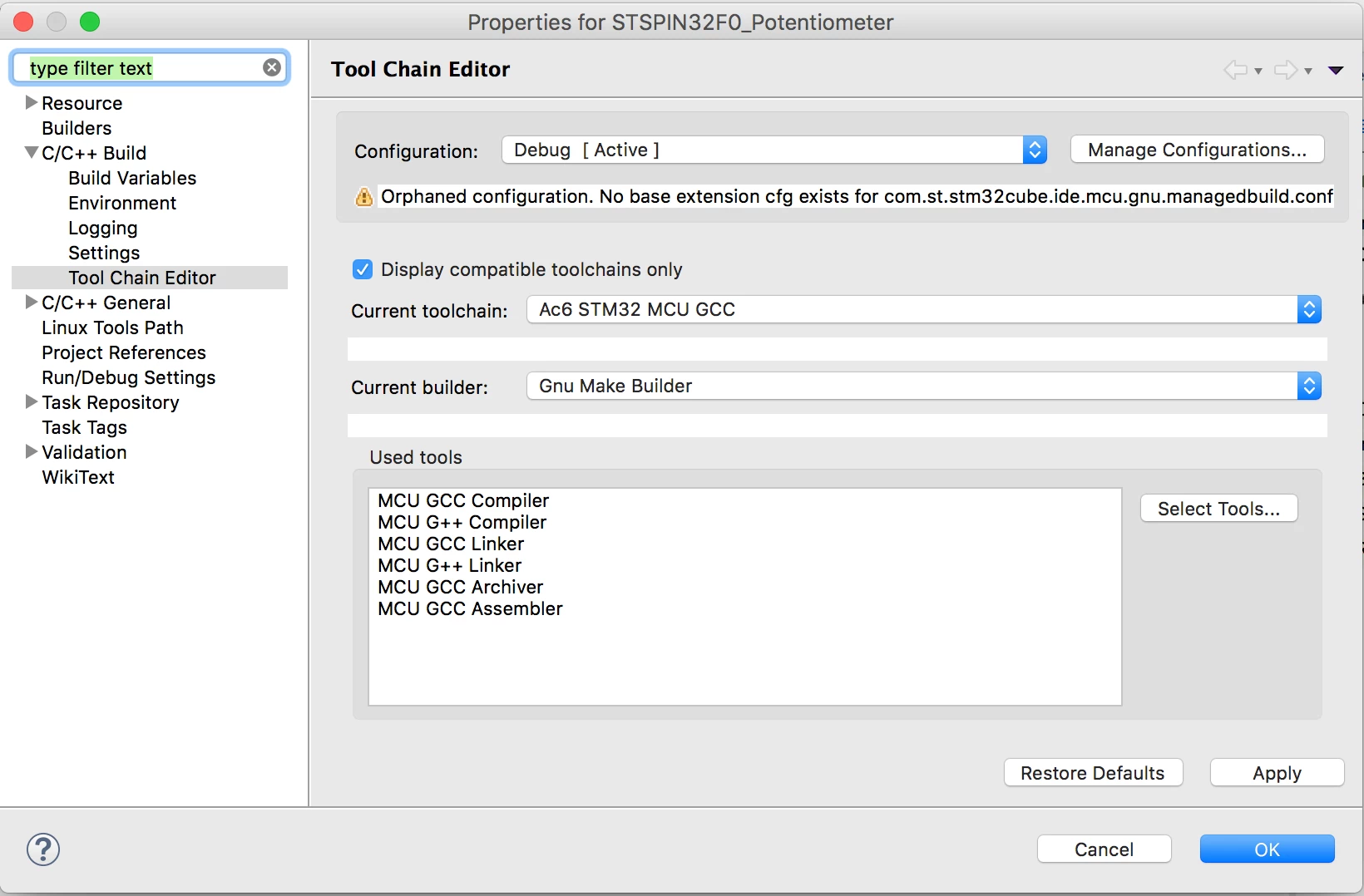

  • I am trying out the 2.5.2.3 build with system workbench for STM32 under the below sw package
https://www.st.com/resource/en/user_manual/dm00446043-getting-started-with-the-stswspin3202-and-stswspin3204-firmware-packages-stmicroelectronics.pdf
  • Imported the STSPIN32F0_Potentiometer and STSPIN32F0_Uart projects in ac6 system workbench
  • When I tried to build it. I am getting the following build error
20:25:45 **** Build of configuration Debug for project STSPIN32F0_Potentiometer ****
make all
User/subdir.mk:23: *** target pattern contains no `%'. Stop.
20:25:45 Build Finished (took 133ms)

  • The build settings show Orphaned configuration. No base extension cfg exists for com.st.stm32cube.ide.mcu.gnu.managedbuild.config.exe.debug.774078966 (Screenshot attached)
Let me know if I have to close this and take this topic to a different forum. Appreciate your help
