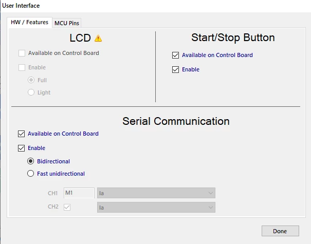

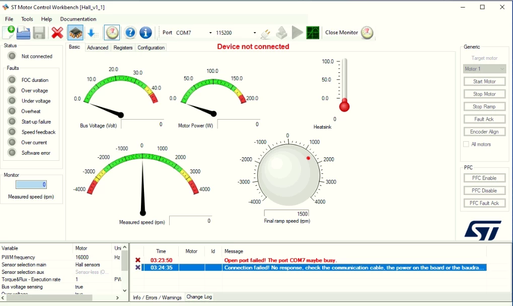

Faced with such a problem with STEVAL-SPIN3202. Does not start the engine, when trying to connect it writes:
"Connection failed! No response, check the communication cable, the power on the board or the baudrate (set to 115200 bps)."
In Keil IDE writes that everything is OK. The firmware is installed.
LEDs on the board show that everything is OK.
Thanks in Advance!

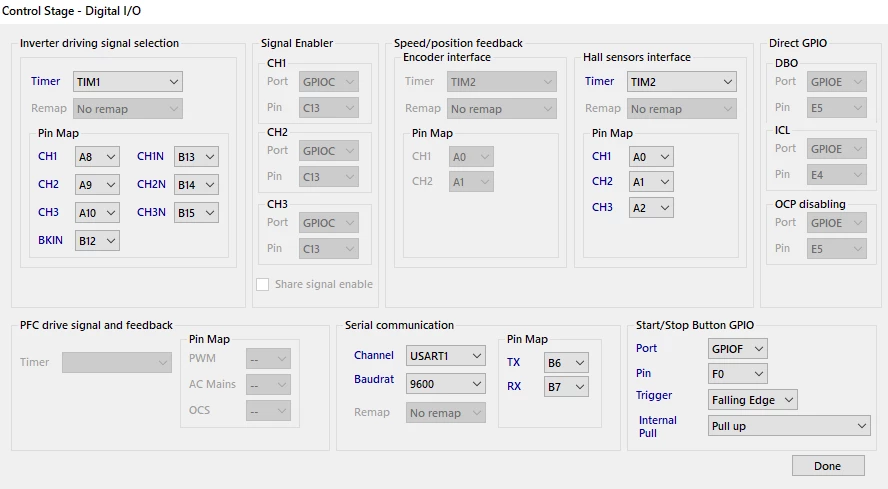

Hello @PKhal.2​ ,
I think the problem is the mismatch between the speed set into the FW configuration (3rd screenshot) and the one set in the monitor (1st screenshot).
Please check if setting 9600bps in the monitor solves the issue.
Enrico
