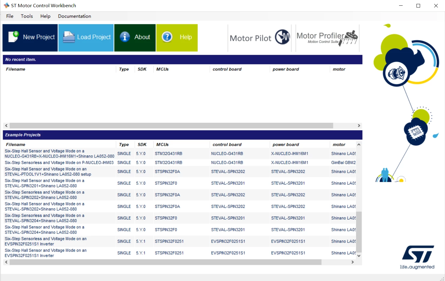

STEVAL-PTOOL1V1 Who has the sample code for STEVAL-PTOOL1V1? I can't find it on ST.com. thanks a lot.

Hello @Dylan.Dong​ and welcome to the ST Community.
As you can read in the board documentation (data brief and user manuals), you can find a firmware example in the STM32 Motor Control SDK (X-CUBE-MCSDK-Y).
The firmware example included in the STM32 MC uses position feedback from Hall effect sensors, with debugging and programming capability available through the SWD interface and the direct firmware update feature.

Dylan.Dong
December 31, 2021
Sorry I​ did not find the firmware example in X-CUBE-MCSDK-Y. Can you help me find it? Thanks.0693W00000HqEeHQAV.png

Hi @Dylan.Dong​ which SW version have you installed?
The STEVAL-PTOOL1V1 is supported by Rev Y 5.5.2 and following.
