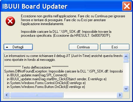

Hi all, I'm working with the STEVAL-PCC009V2 board and the EVAL6480H, I'm try to update the STEVAL-PCC009V2 firmware by means the application IBUII updater on WinXP Pro SP3 but every time the application fail to start with a no found DLL error.
At the first was about the setupapi.dll so I've overwritten the original one into the Updater folder with the one taken from the WINDOWS\System32 and this error was solved, after that I got another unhandled exception about the SPI_SDK.dll, I've attached the screenshot nag for details, this DLL is still present into the folder so I'm stuck and no idea how to proceed.
Someone can give me a little bit help on this subject?
Thank
