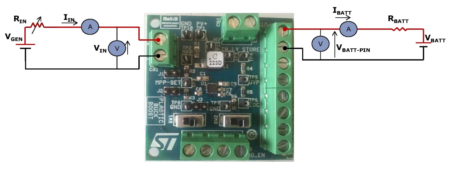

I use my solar panel connected to the STEVAL-ISV020V1 to charge my LiPo battery. Everything works fine and it charges the battery. However since I am trying to charge it indoors, during night-time, my solar panel doesn't reach the min required voltage of 2.6 to operate the STEVAL-ISV020V1.
Now I am wondering if the STEVAL-ISV020V1 becomes a load instead of being a charge controller when this happens because it drains the battery with a very low voltage at a certain time.

Is the battery connected to VBATT (CN2.1) or to STORE (CN4.1)?
What else is connected to the battery as a load?
rsmquAuthor
Feb 1, 2024 10:56 AM UTC
Hi @Peter BENSCH ,
I followed this diagram below attached screenshot from its datasheet:
The Solar panel is connected to CN1 and the battery is connected to the outputs. No other connections were used to the battery.
Solar Panel -> STEVAL-ISV020V1 -> LiPo Battery
Peter BENSCH
Feb 1, 2024 11:36 AM UTC
The evalkit is the Buck-Boost variant, which only starts from 2.6V when a PV panel is first connected, but can then work down to 150mV and even charge the battery, even if only very low charging currents are flowing. The battery is disconnected from STORE as soon as its voltage exceeds EOC and connected when the voltage falls below EOC (see SPV1050 data sheet mentioned above).
