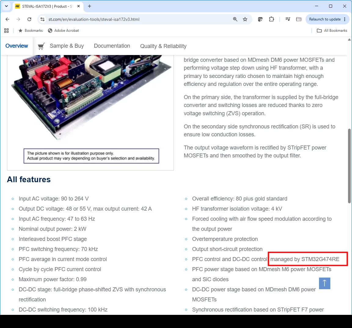

Is there a version based on the STM32G4 available?
According to the Product Page, it is based on an STM32G4:
Is the firmware package available for download?
As always, all the available resources, downloads, etc are on the Product Page - firmware would be on the ‘Tools & Software’ tab.
When it’s not on the Product Page, that means you have to request it directly from ST - probably under NDA.
Find your local sales office here: https://www.st.com/content/st_com/en/contact-us.html
Or raise a support case here: https://ols.st.com/s/
