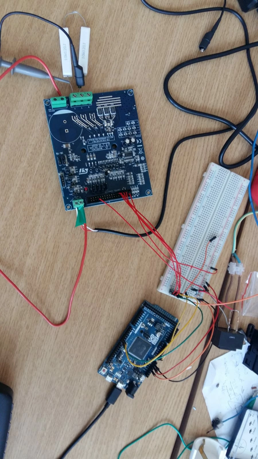

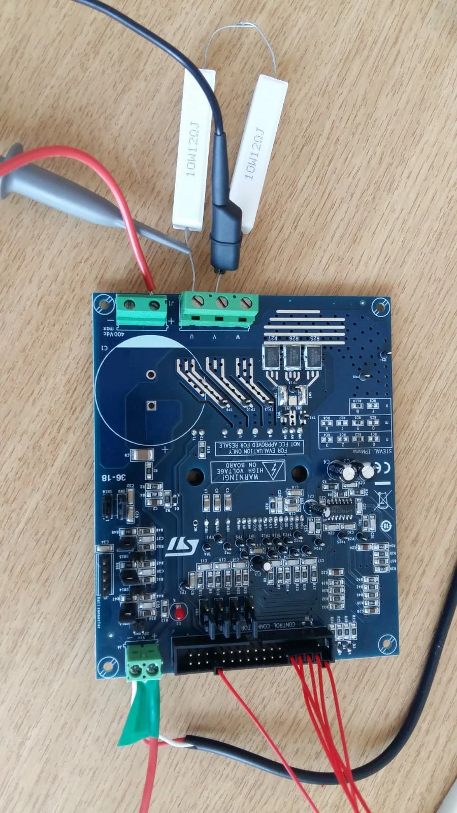

I was using the STEVAL-IPM15B board to generate a single phase output between the U and V phases on a 24 ohms resistor load. Thus, I was also using only 2 pairs of IGBTs (A and B) out of the 3 available. Everything that was connected to the W phase (which I was not using) was left not connected.
I was commanding the IGBTs via sinusoidal PWM signals generated by a 32-bit microcontroller board. I did this by separating the result of the PWM algorithm into 2 separate outputs , 1 for each half period (positive/negative) of the sinusoidal reference signal. A separate line of code was written to always ensure that both outputs are not 1 at the same time, since I saw that the inverter didn't have an interlocking function. Then, each output was connected to the corresponding pins of the STEVAL-IPM15B board (output 1 with PWM-1H and PWM-2L and output 2 with the reverse). I also connected the GND and the 3.3V pins. Everything else I did not use.
For both the DC supply, as well as the Vcc supply, I used a PC adapter of 15 V and 3 A. I'm aware that the DC supply technically requires a minimum of 125 V in order to function properly, but for the purpose of my project, in which I only needed to generate the single-phase voltage on the resistor load, 15 V were enough.

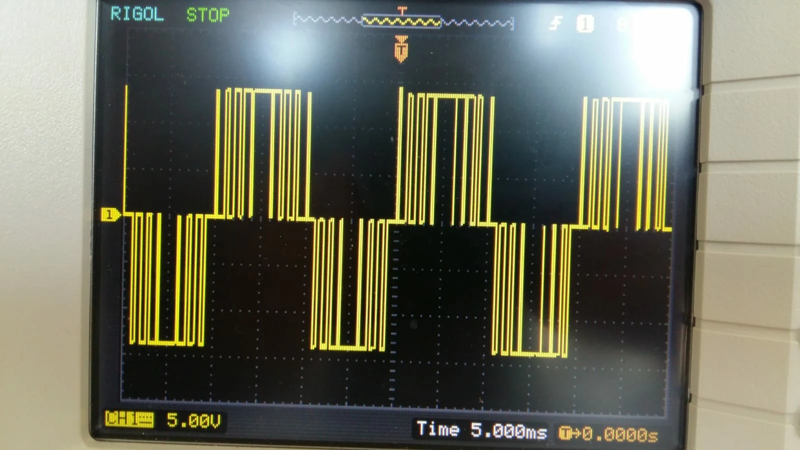

At this point, everything was working properly and I was able to view the desired voltage between U and V using an oscilloscope. I also attached pictures with this result, as well as the setup.

Then, the only change I made was that I changed the variable that controlled the sinusoidal signal to 90 degrees, so that now the output between U and V should be exactly the same, only 90 degrees out of phase with the grid voltage. As soon as I uploaded this change to the micro-controller board, while it still being connected to the STEVAL-IPM15B, as well as powered up from the 15 V supply, the STEVAL-IPM15B started smoking from somewhere near the inverter chip (couldn't see exactly where since it was underneath) and the chip burned, not working anymore. I unplugged it as soon as I could, but it was too late already.
It is clear that the board somehow short-circuited, but I cannot understand how. It was working properly with the last code before I changed that variable to 90 for somewhere between 2-3 hours. During this time, I checked regularly and the inverter chip wasn't getting hot almost at all, only the resistor load did. I also checked with the oscilloscope that the 2 PWM outputs would never overlap, so the interlocking protection that I wrote was also working properly. The power supply that I used had only 3 A and it also had short-circuit protection. The STEVAL-IPM15B board itself also has protection for something like this. I'm not ever sure that changing that 1 variable to 90 even had time to take effect, since the code has a written delay until the synchronization starts being verified, while the board started smoking immediately. So, I'm asking if there's something going on with how the board/inverter is working internally which I'm missing.

Something similar happened to me. I used 165v power supply, first the C9 exploded, it's rated to 400v, I have no idea why. Next the board was working fine when the shunt resistor exploded, I turned off all and checked the IGBT module, VCC was in shorted circuit with NU terminal. I also expected the IGBT module to protect for over current, but seems the protection is just be in short circuit and damage the IGBT module.
